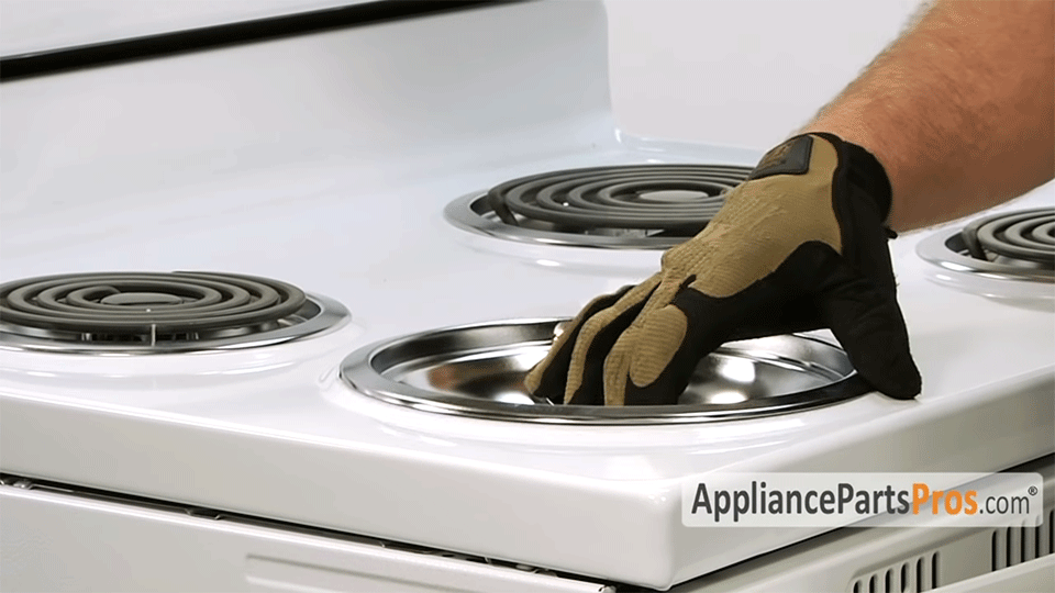

Second Step: Remove the drip pan
With the heating element out of the way, you can remove the drip pan. On some models, the drip pan may be held in place by a screw, but this usually isn’t the case. Simply lift the drip pan out and set it aside – or take this time to give it a thorough cleaning!

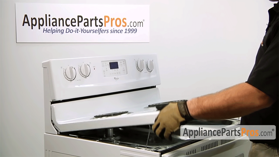

Third Step: Lift the top of the range
Did you know, most range tops lift up the way a car hood does? It’s an easy way to clean any crumbs or spills that have gotten past the drip pans, and to repair and replace components like faulty burner receptacles.
To open the top, grip it on either side and lift it up. If your range is the type that has metal rods to stabilize it and keep it open, pull it up high enough that those lock into place.

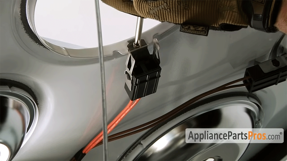

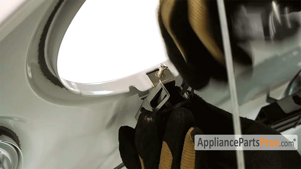

Fourth Step: Remove the receptacle block from the stovetop
The receptacle block is going to be held in place by a single screw. Grab your Phillips screwdriver to remove it, and hang onto the screw in case you need it when installing the new block.

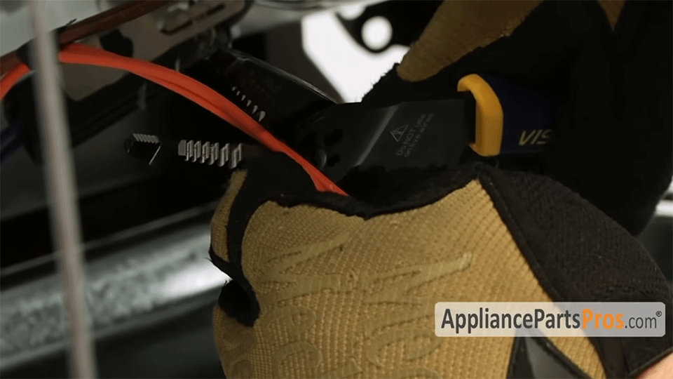

Fifth Step: Cut the old receptacle block out
Be absolutely sure your range is not receiving power before completing this step! Once the old receptacle is detached from the underside of the cooktop, cut it free from the wiring system with your wire cutters/strippers.
With that done, you can use the strippers to strip the ends of the wires still attached to the range. You’ll want to strip away about a half an inch of wire insulation.

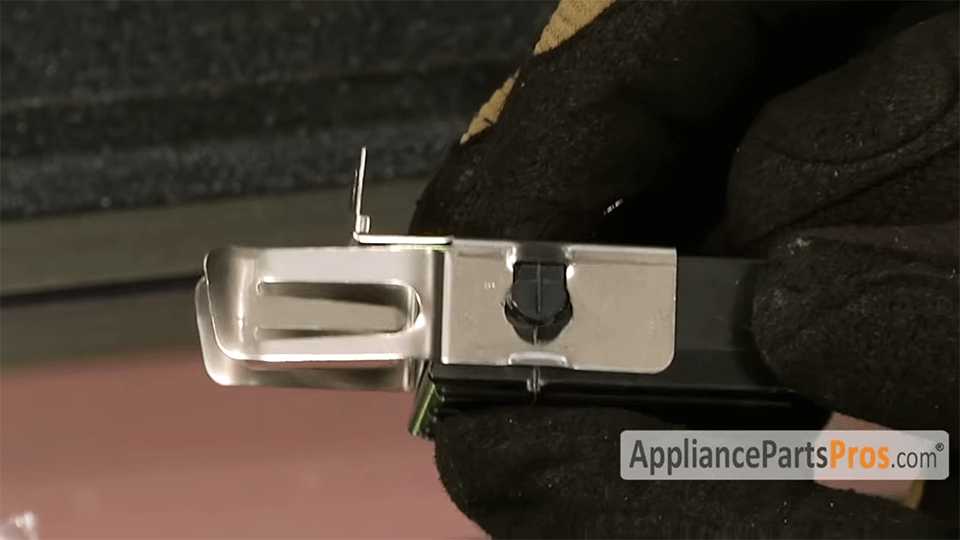

Sixth Step: Assemble the new terminal block
If your receptacle block came disassembled, now’s the time to put it together. The kit in our video came with two different brackets, and to proceed we selected the metal bracket that matched our old receptacle.
To assemble, slide the bracket onto the plastic terminal block. It’ll snap into place. Then, push the wire terminals into the plastic block. These should lock in place, so once you’ve pushed them in as far as they’ll go, give each one a tug to make sure they don’t come back out. If they’re not staying secure, turn them around and try again.

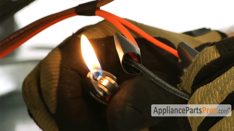

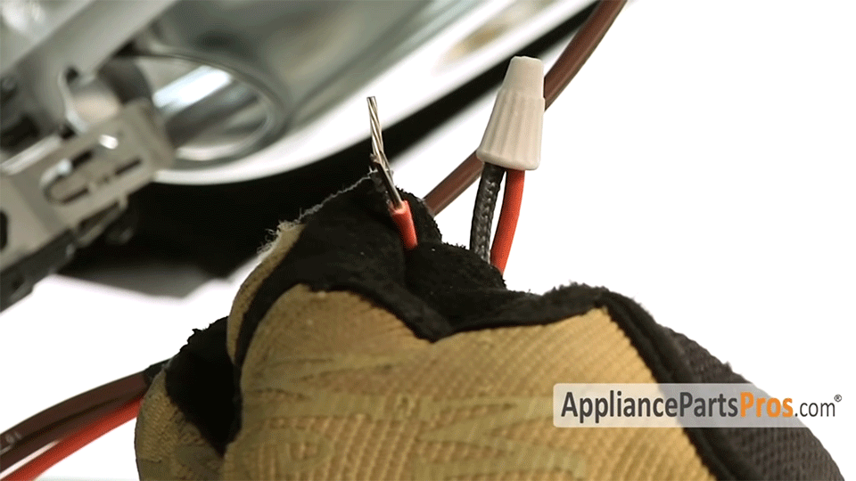

Seventh Step: Attach the new terminal block to the range’s wiring
Start by sliding one heat shrink tube over each of the oven-side wires. Then pair each of the new receptacle’s wires to one of the oven-side wires and secure them with wire nuts. It doesn’t matter which goes where.
With the wire nuts on, bend the nuts over the wires and slide the heat shrink over everything. You can then heat up the heat shrink with a lighter to melt it down and secure it. Take care with this step!
Eighth Step: Secure the new range burner receptacle to the cooktop
Steady the receptacle in place with one hand while replacing and screwing down the mounting hardware.
Nineth Step: Put the drip pan and heating element back in place
Release the supports and push the range top back down. Next, set the drip pan into place. Make sure it’s properly aligned so that the hole in the drip pan leaves the receptacle block open. Once that’s in place, you can push the heating element back into place.
