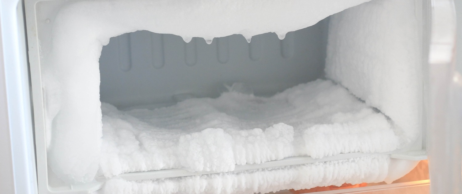

Is your refrigerator transforming into an igloo instead of keeping your food cool and fresh? It’s time to tackle that pesky defrosting issue head-on before frost takes over your fridge. Dive into our easy-to-follow guide and discover how you can bring your appliance back to its prime; don’t miss the helpful how-to video just below to walk you through the process!
If your refrigerator has a problem with the ability to defrost, you may notice an ice buildup and assorted issues with cooling the rest of the refrigerator. Before you get underway with an inspection of any of the refrigerator parts, it’s essential to make sure the work area is safe. The circuit breaker should be turned off or the refrigerator should be unplugged. The water supply under the kitchen sink should also be turned off. Follow this easy guide to diagnose which refrigerator part failure may be the problem.
