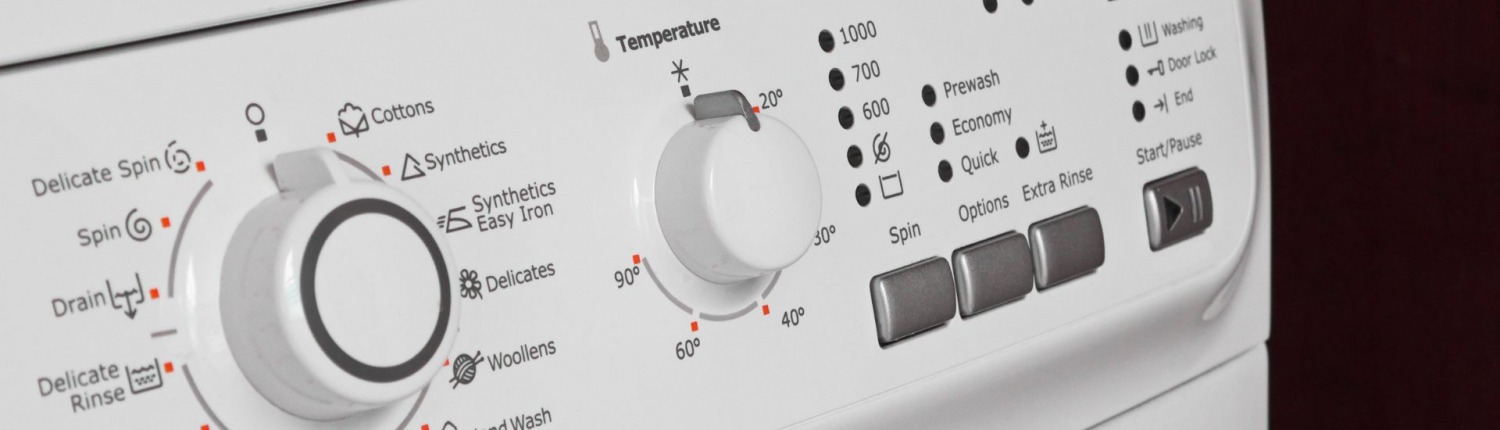

Verify the water temperature settings
- Check the Auto Temperature feature: Make sure the Auto Temperature feature is set correctly according to your laundry needs. This feature automatically adjusts the water temperature based on the selected cycle.
- Run the diagnostic test mode: Some Samsung washers have a diagnostic test mode that allows you to check various functions, including water temperature. Consult your user manual for instructions on how to enter the diagnostic mode for your specific model.
- Manually measure water temperature: Fill a bucket with hot water and measure its temperature using a thermometer. Compare this reading with the temperature displayed on your washer’s control panel during a wash cycle.
- Verify correct hot water supply: Check that the hot water supply hose is properly connected to both the washer and the faucet. Make sure there are no kinks or blockages that may affect proper water flow.
- Confirm voltage supply: Make sure your washer is receiving an adequate voltage supply from your electrical outlet. Low voltage can result in incorrect water temperature readings.
