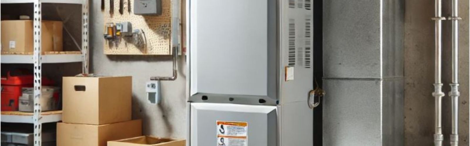

Is your furnace running non-stop, turning your home into a sauna or driving up those energy bills? A furnace that won’t quit isn’t just annoying—it could be signaling some issues that need attention. Let’s take a look at some common reasons this might be happening and what you can do about it.
