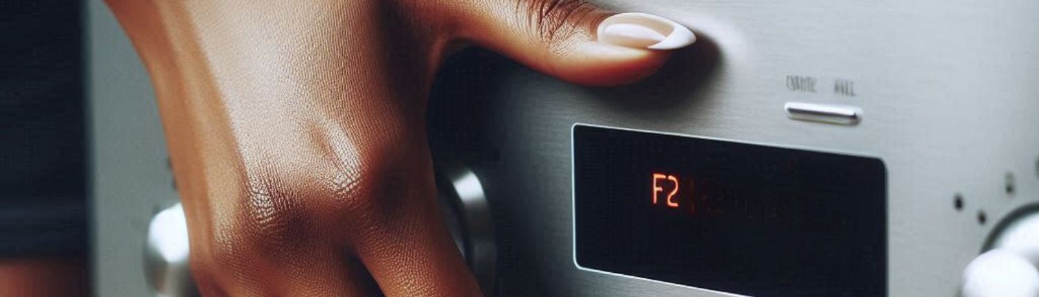

One of the more common issues in GE gas range models is the F2 error, which is a code that usually displays when there’s an issue with the temperature.
While you might not get much information from seeing the F2 error, remember that your range is trying to direct you to the point of failure. By inspecting and testing parts, you can find the source of the F2 fault code and get your machine working correctly again.
If you find out that you need any replacement parts for your GE range while you’re troubleshooting, you can enter your model number at AppliancePartsPros.com to order them. Most orders arrive in just two business days, and we have thousands of free guides to show you how to install your new parts.
Important: The error code information in this article is based on general service manuals and may not apply to your specific appliance model. While we strive to offer helpful advice for DIY appliance repairs, variations in models and configurations can lead to differences in troubleshooting steps, error codes and part replacements. For the most accurate guidance, we strongly recommend consulting the technical sheet for your specific appliance model.
What does the F2 error code mean?
The F2 error code usually indicates that the oven is over 640°F while the door lock isn’t in the proper position, or that the oven is above 915°F while the door lock is in the correct position. This overtemperature condition is detected by the control board and is based on input from the oven sensor.
The F2 error can appear during normal cooking or self-cleaning modes. Once it recognizes the high temperature, the board flashes the F2 code to alert the user to the problem.
There are a few possible root causes that could trigger the F2 code:
  • A malfunctioning oven temperature sensor that’s sending incorrect data to the control board. Bad sensor data will lead to bad oven temperature control.
  • An oven door that isn’t sealing properly when it’s locked during self-clean mode. Gaps or leaks can allow heat to escape.
  • A faulty cooling fan. This can cause the circuits to overheat.
  • A malfunctioning control board.
