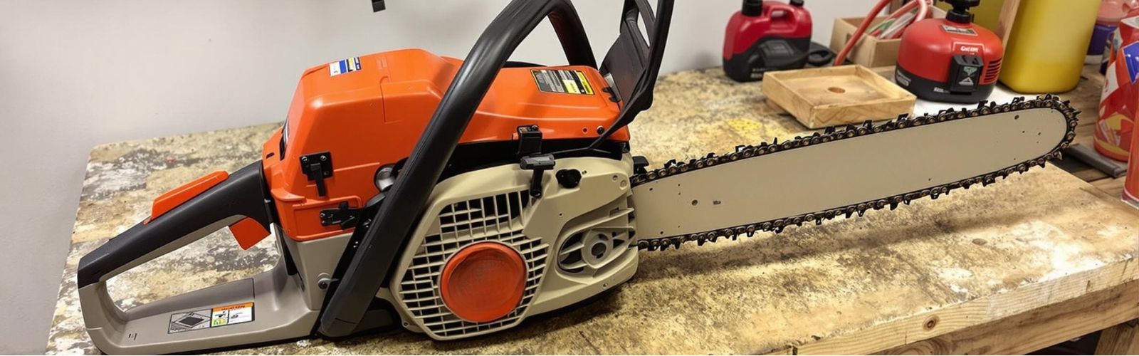

Ever been ready to get to work with your chainsaw, only for it to sputter and refuse to start? A flooded engine can really throw a wrench in your plans. Signs like excessive smoke, a strong fuel smell, or spark plugs soaked in fuel mean something’s off. Knowing how to clear a flooded engine can get you back on track and tackling those cutting jobs without a hitch.

Steps to clear a flooded chainsaw engine
  1. Turn off the choke: If the choke is still on, turn it off. Keeping it on will continue adding fuel and make things worse.
  2. Engage the throttle: On many models, you can lock the throttle open (wide open position) using the trigger lock or throttle lock. This helps more air move through the engine to clear out the fuel.
  3. Switch the ignition ON: Make sure the ignition switch is in the “on” position before you start pulling.
  4. Pull the starter cord 6–10 times: Pull the cord several times with full throttle and no choke. This helps push the extra fuel out through the exhaust. Don’t worry if it doesn’t start yet, just focus on venting the fuel.
  5. Remove and inspect the spark plug: Take out the spark plug using a socket wrench. If it’s wet with fuel, dry it off with a clean rag or use compressed air. Let it air out for a few minutes if needed.
  6. Pull the starter cord a few more times with the plug out: This vents any remaining fuel from the cylinder. Be sure the ignition is off during this step to avoid accidental sparks.
  7. Reinstall the dry spark plug: Once it’s clean and dry, screw it back in and reconnect the spark plug wire.
  8. Start the engine with no choke and throttle open: Try starting the saw again without the choke and with the throttle engaged. It may take a few pulls, but it should fire up.
Pro Tip: To avoid flooding next time, follow the manufacturer’s recommended cold start procedure closely and don’t over-prime or choke longer than necessary.
