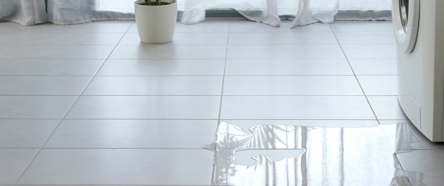

Is your washing machine leaving a surprise puddle on your laundry room floor? Don’t worry, you’re not alone. Solving this common homeowner dilemma is easier than you think, and with our step-by-step guide and accompanying how-to video below, you’ll have the know-how to fix the leak and get back to your regular wash routine in no time.
Once you have identified the part needed for your washer, search below using your washing machine model number to identify the exact part needed:
If your washing machine is leaking, there’s no need to panic! When there’s a puddle in the laundry room, you can usually fix the issue on your own within an hour or so. The first order of business is to identify the reason behind the leak. To help you out, our experts at Appliance Parts Pros.com have put together this step-by-step guide to determine why your washing machine is leaking and what part you’ll need to replace to get it spinning again.
