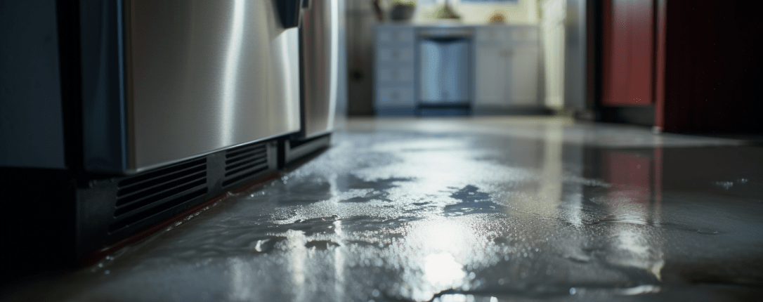

It can be alarming to open your refrigerator and see water pooled at the bottom. While this is concerning, some common issues are usually to blame and can often be fixed with simple solutions. Water buildup usually happens when the defrost drain becomes blocked, the drain pan underneath is dirty or cracked, or a water supply line is damaged. This article will explain these typical causes of water pooling in the refrigerator and outline the steps to remedy them. Whether it’s unclogging the defrost drain, cleaning the drain pan, or replacing a broken line, the goal is to provide troubleshooting tips to stop water leakage and properly maintain your refrigerator. Read on to diagnose what’s causing the water buildup and learn how to fix it.
What Causes Water to Pool in the Refrigerator?
There are a few common culprits that can lead to water collecting at the bottom of your refrigerator. First off, a clogged defrost drain is a likely cause as it prevents water from properly draining during the defrost cycle. Food particles, debris, and mold buildup can block the drain over time. On top of that, a dirty or cracked drain pan can cause water pooling issues. The drain pan is supposed to collect water from defrosting and allow it to safely evaporate, but dirt, grime, and damage prevent this.
Lastly, refrigerators with water dispensers can spring leaks in the supply lines, leading to backflow of water into the fridge interior. In short, the main reasons you may find standing water in your refrigerator include blockages in the defrost drain, an unclean or damaged drain pan underneath the appliance, or leaks in the water supply lines. Identifying the specific cause is key to fixing the water buildup problem.
