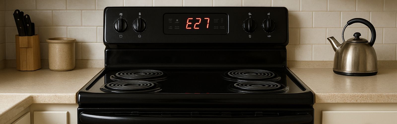

When the E27 error code appears, it signifies that the oven’s internal temperature monitoring system is failing to accurately detect and regulate the heat levels. This can result in inaccurate temperature readings, potentially causing food to be overcooked or undercooked.
The primary cause of the E27 error is typically a faulty or electrically open oven temperature sensor. This could be due to physical damage, loose wiring connections, or issues with the oven’s electronic control board.
