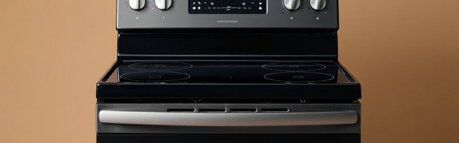

Is your Samsung range displaying error code SE (which may look like 5E)? Don’t worry, this is a problem that you can fix yourself without the need for a costly service call and we’re here to help you learn how to do it like a Pro!

The error code “SE” or “5E” indicates a shorted key on the range’s control panel keypad. This error code suggests that the control board is detecting a constant or intermittent short circuit in the keypad, which could be caused by a shorted keypad, problem with the wiring connection or a bad main PCB.
