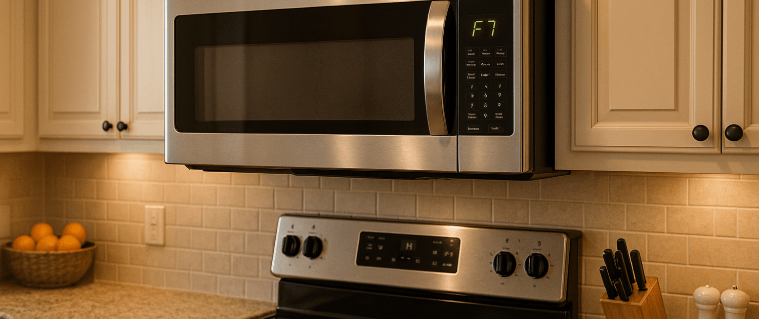

Is your microwave oven displaying an F7 error code? This usually indicates a problem with power getting interrupted by the internal magnetron tube. Without consistent power, the magnetron can’t generate the microwaves needed to cook foods. With some basic troubleshooting steps, you can diagnose the cause, resolve the F7 Whirlpool microwave error, and get your microwave heating properly again.

The F7 error code is the microwave’s way of signaling there is a power interruption to the magnetron circuit. This is typically caused by an issue with one of the following oven components:
- Cooling fan
- Magnetron
- Door interlock switches
- Wiring and connections
- Electronic control boards
Without fixing the F7 error, your microwave won’t produce any energy to actually cook the food!
