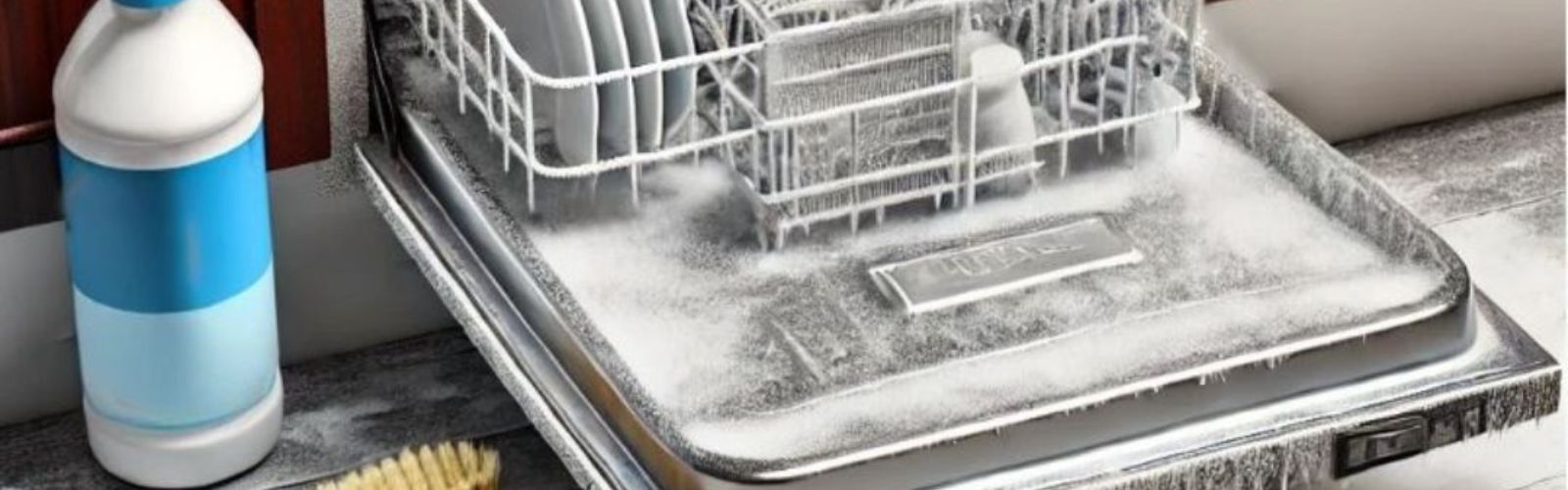

You open your dishwasher, expecting to find sparkling clean dishes, but instead, you’re greeted by a stubborn white film clinging to the interior and sometimes your dishes. This residue is more than just an eyesore; it can affect your dishwasher’s performance and the cleanliness of your dishes.
But what exactly is this white gunk, and how can you get rid of it for good? Don’t worry! We’ll help you understand what’s causing the problem and walk you through practical steps to clean your dishwasher and prevent the buildup from coming back.
What is the white stuff in the dishwasher?
In most cases, the white residue is caused by mineral deposits, particularly calcium and magnesium, from hard water. When the water in your dishwasher evaporates, these minerals are left behind, forming a chalky film. If you have hard water, this buildup is likely to happen more frequently.
Another common culprit is soap scum, which forms when detergent combines with hard water minerals or grease. And don’t forget food particles, leftover bits can mix with grease and detergent, creating a nasty sludge that adds to the gunk.
