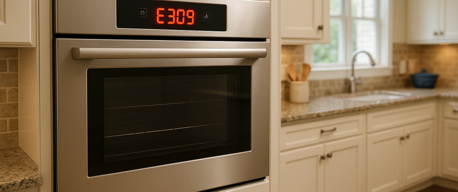

What does the error code mean?
On Bosch gas slide-in ranges, the E309 error code indicates that the control module has failed an internal ROM (Read Only Memory) check on startup.
The control module contains the logic board and programming that operates the various oven functions. At power-up, it runs a self-check on its internal ROM chip.
The E309 error signifies this ROM check has failed and the control module needs to be reset or replaced. It’s not a common error but can occur over time from electrical spikes or power fluctuations corrupting the module’s memory.
When an E309 is present, the oven will be unresponsive and won’t heat up. A control module reset or replacement is required to resume normal operation.
