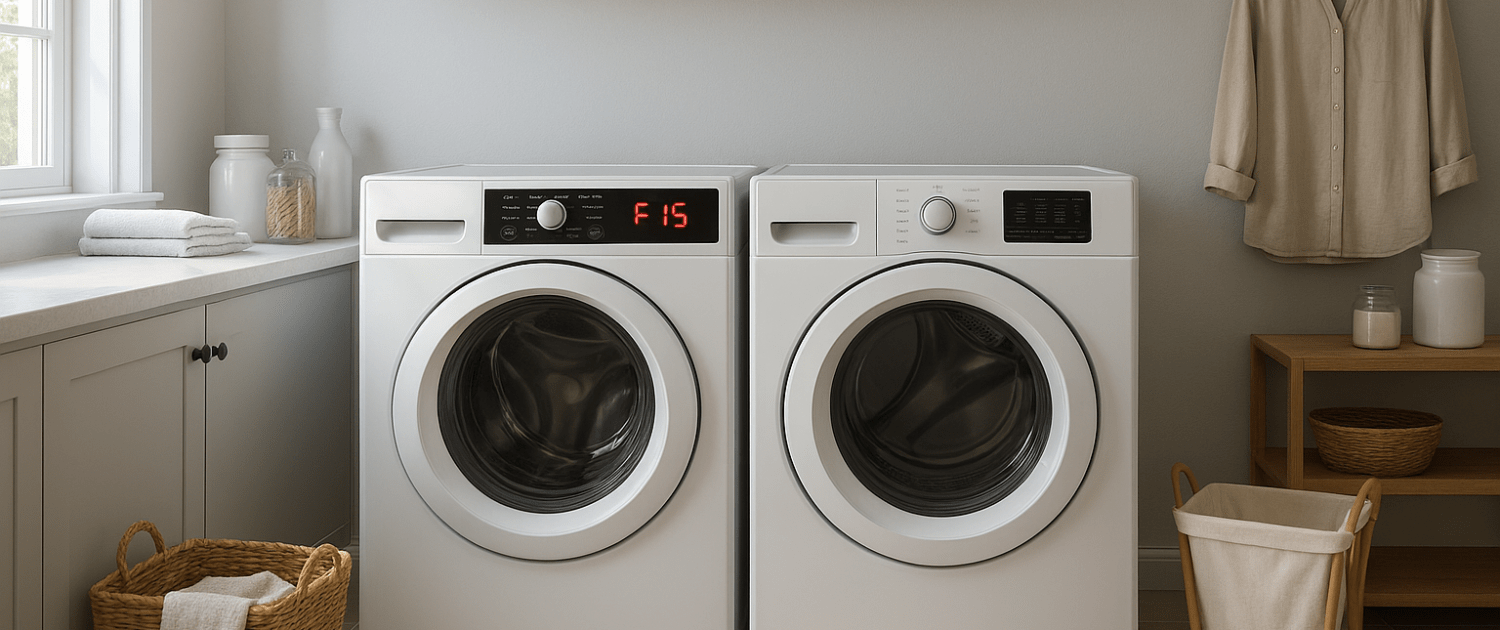

Is your Whirlpool front loader displaying an F15 error code and refusing to spin or wash correctly? This common error is often caused by a minor electrical issue that you can likely fix yourself. We’ll break down what’s behind the F15 Whirlpool washer error code and how to resolve the problem. Read on to learn how to get your Whirlpool washing machine running dependably again.

What does the error code mean?
On Whirlpool front-load washing machines, the F15 error code indicates an issue with the motor control unit (MCU). Specifically, it means the central control unit (CCU) has detected a short circuit somewhere in the MCU electrical components.
This error typically occurs during the high-speed final spin portion of a wash cycle. When the CCU senses a motor control unit error, it displays the F15 code on the washer’s screen.
For safety, the washer will also unlock the door after 3 minutes when this code appears. This allows you to open the door if the error occurs mid-cycle.
Essentially, the F15 code means there is a communication breakdown between the washer’s central control unit and the motor control unit. This prevents the CCU from properly instructing the motor during the spin cycle, resulting in the error.
While this issue is frustrating, it is often caused by a faulty connection or wiring problem rather than a defective part. With some basic troubleshooting steps, you can likely resolve the F15 error yourself without a costly appliance repair call.
