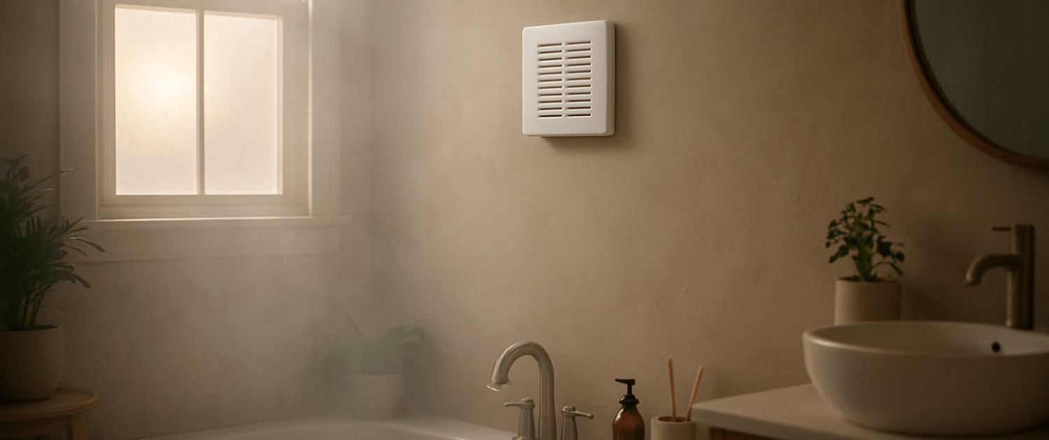

A bathroom exhaust fan is supposed to be your first line of defense against moisture buildup, mold, and stale air. It quietly whisks away moisture and odors, keeping your bathroom clean, dry, and free of mold. But what happens when it stops doing its job, when your bathroom mirror stays fogged up, or worse, you start noticing peeling paint or mildew creeping in?
If your bathroom fan isn’t removing moisture like it used to, you’re not alone. It’s a common issue, and luckily, most of the time it’s something you can fix yourself. In this article, we’ll walk you through why your bathroom fan may not be working properly and what you can do about it, step by step.
