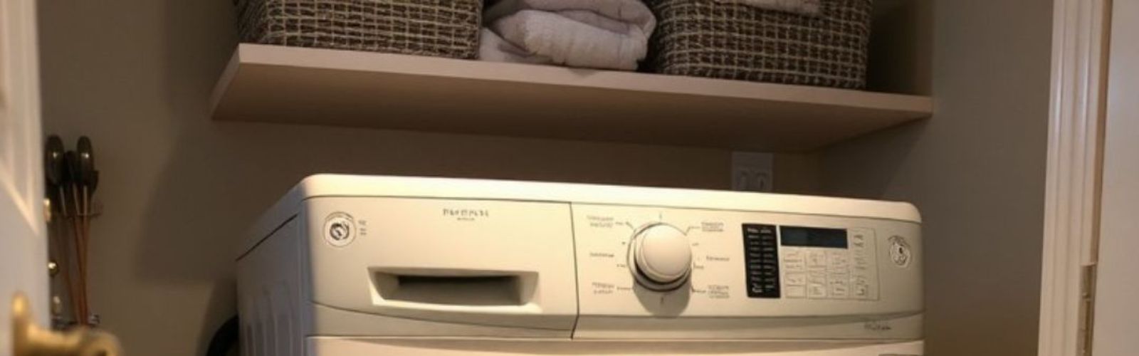

Whirlpool front load washer is dead or has no display: How to fix it
Steven E / Friday October 11, 2024
If your Whirlpool front load washer is completely dead or has no display, it can be frustrating and inconvenient. Before calling a technician, there are several troubleshooting steps you can follow to diagnose and fix the issue yourself, like a Pro!
