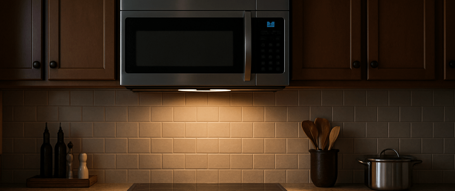

Is your Whirlpool microwave leaving you in the dark? It might not be just the bulb, but a faulty light socket causing the issue. Don’t worry, we’ve got you covered with an easy, step-by-step video tutorial right below that will guide you on how to replace that malfunctioning part and brighten up your cooking space again!
