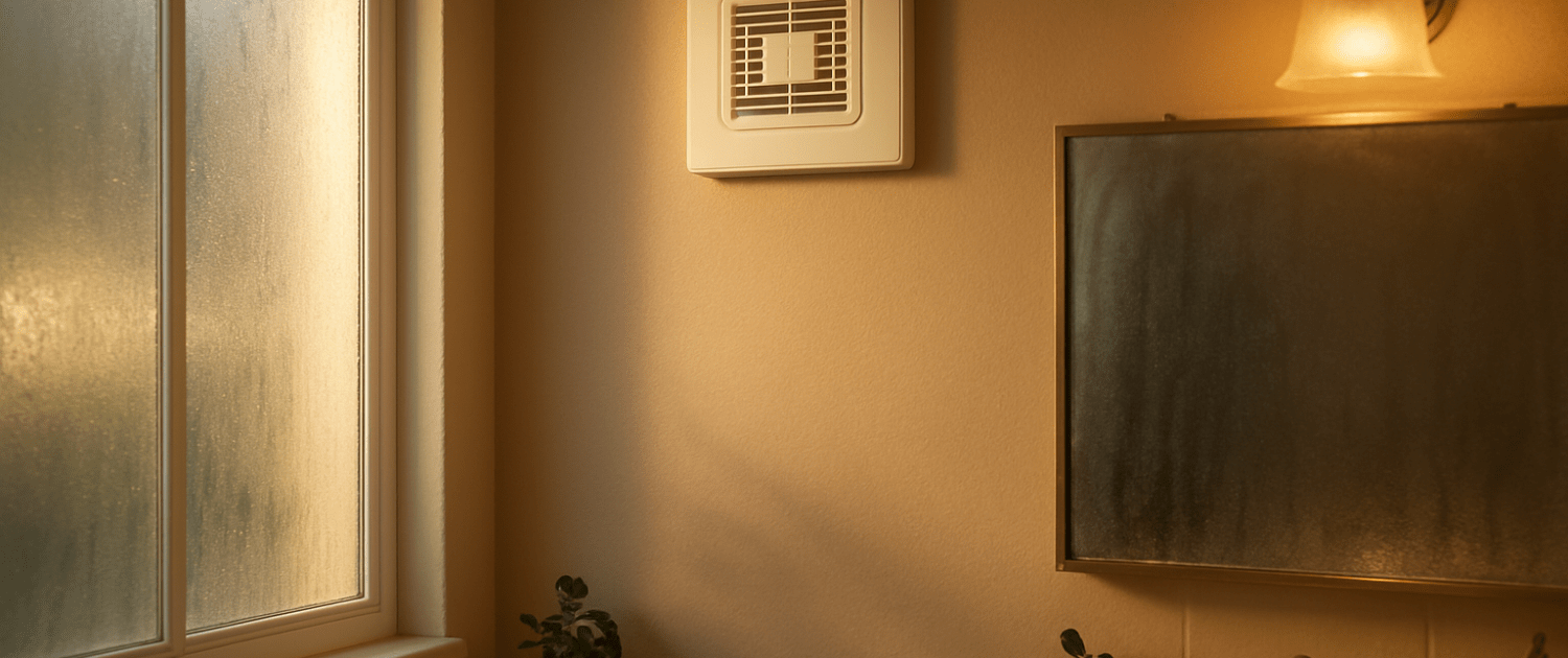

You flip on the bathroom fan, take a quick shower, and yet your windows are fogged up like you ran a steam room in there. What gives? A bathroom fan is supposed to clear out moisture, not make it worse. But if it’s causing condensation on your windows, chances are it’s not venting properly, pulling in outside air, or simply underpowered. In this guide, we’ll break down why this happens and how to fix it so your bathroom stays clear and mold-free.

Condensation forms when warm, humid air meets a cooler surface, like a bathroom mirror, tile wall, or glass window. The cooler the surface, the more likely water vapor will condense into visible droplets. In bathrooms, hot showers or baths dramatically raise the moisture level in the air, and without proper ventilation, that moisture has nowhere to go.
Bathroom windows are especially prone to condensation because glass is a poor insulator and quickly cools down the moist air in the room. Ideally, your bathroom fan should reduce humidity enough to prevent that from happening, but if it isn’t doing its job correctly, or if it’s set up in a way that disrupts airflow, the result can be foggy or dripping windows.
