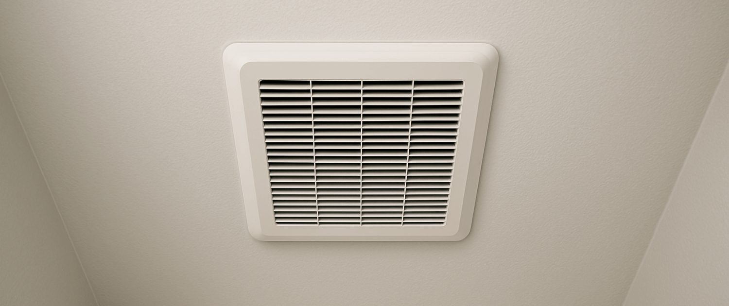

If your bathroom fan suddenly sounds like a jet engine or a buzzing fly trapped in the ceiling, you’re not alone. Many homeowners run into this exact problem, what used to be a quiet, functional fan is now rattling, humming, or grinding. A noisy bathroom fan can be annoying, disruptive, and sometimes a sign of a larger issue.
The good news is, most loud bathroom fans can be diagnosed and repaired with a bit of investigation and some basic tools. In this guide, we’ll walk you through the most common causes of loud bathroom fan noises and offer practical, do-it-yourself solutions to help quiet things down.
