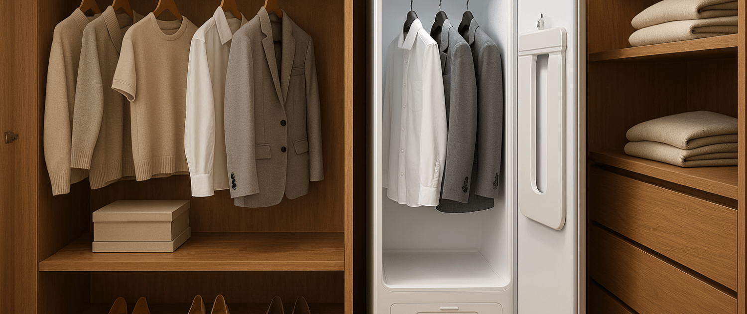

A laundry steam closet is one of those appliances that makes life easier, and your clothes look amazing. With just the push of a button, it steams away wrinkles, refreshes fabrics, and even sanitizes. But if you’ve opened yours lately to find a pool of water sitting at the bottom, you already know something’s not working the way it should.
We’ll show you step-by-step how to figure out what’s causing the water to pool and what you can do to fix it.
The information in this article may not apply to your specific appliance model. We recommend consulting your manufacturer’s documentation or contact us with any questions.
Why Is Water Pooling in Your Steam Closet?
Your steam closet works by heating water into steam, which fills the chamber and treats your clothes. That steam then condenses back into water, which is supposed to drain away neatly through a drain hole or hose into a tray or outflow.
When water ends up pooling instead, it usually means something in that drainage system has stopped working as it should.
