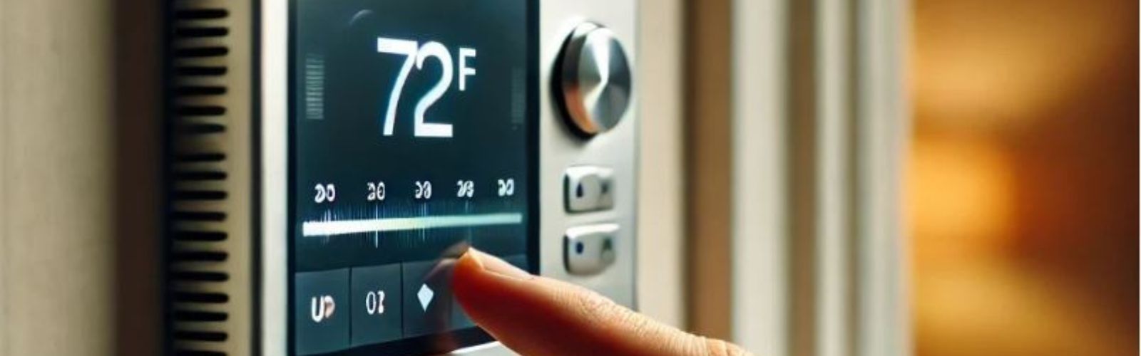

Faulty thermostat
A malfunctioning thermostat can also cause your furnace to shut off before reaching the set temperature. If the thermostat is reading the temperature incorrectly or not communicating with the furnace properly, it may stop the furnace from running long enough to reach the desired warmth.
How to fix it:
  1. First, check the thermostat settings. Make sure it’s set to the correct temperature and that it’s not accidentally set to “off” or “cool.”
  2. If your thermostat is battery-operated, replace the batteries. Weak batteries can lead to poor performance.
  3. Clean the thermostat by gently dusting around the display and adjusting dial or buttons so that there are no obstructions or debris affecting it.
  4. If you have a digital thermostat, check if it’s displaying the correct temperature and responding to changes. You can recalibrate the thermostat if it’s giving inaccurate readings.
  5. To test the thermostat, you can use a multimeter. Set it to measure resistance (ohms), and check the wiring to ensure that the thermostat is providing the right signals to the furnace.
  6. If there’s no continuity when the thermostat should be sending a signal, it could be faulty and need replacing.
