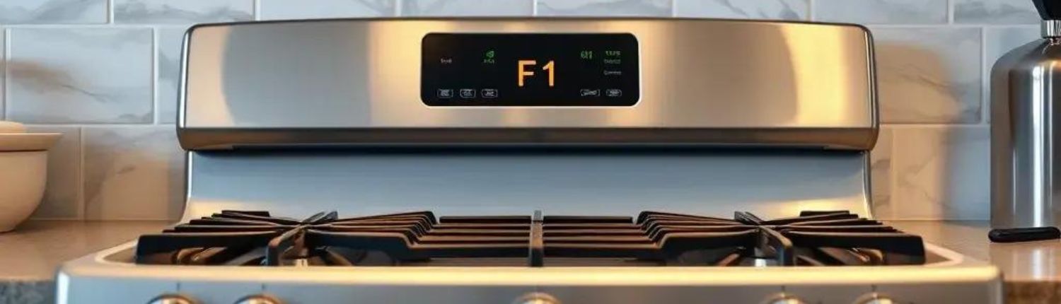

What does the F1 error code mean?
An F1 error on a gas LG range usually indicates an issue with the oven temperature sensor. This sensor monitors the temperature inside the oven cavity and provides that data to the main control board. A faulty temperature sensor interrupts this process and causes the range to throw an F1 error.
