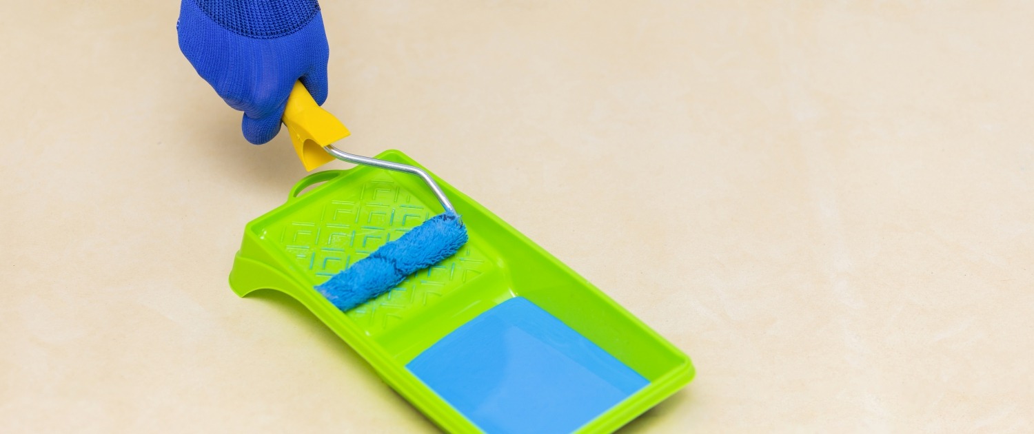

Spray Paint Or Paint Brush?
For the most part, it’s up to personal preference. You can’t tint appliance epoxy and using a brush or roller risks leaving behind streaks, so outside of potential cost savings, there’s no real benefit to opting for a traditional paint can. Using spray paint will give you an even coating, and, done right, you’re less likely to leave behind streaks. If you do need to use paint from a can instead of spray paint, we suggest using a roller if you’re covering a large surface and saving the brushes for smaller areas and detail work.
