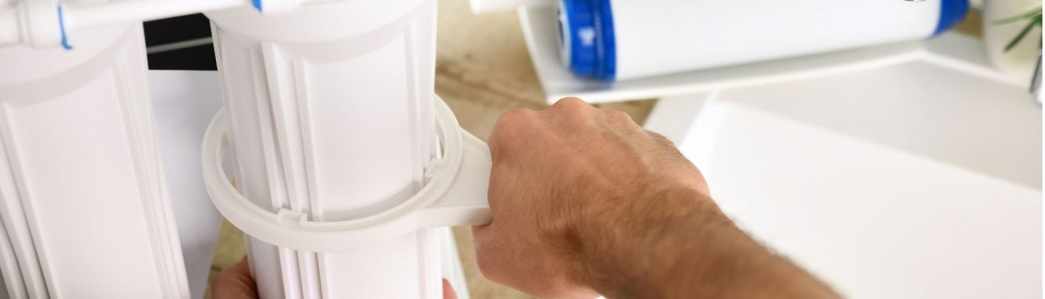

man mounting water filter system
2. Mount the reverse osmosis unit
With the water source prepared, it’s time to mount the reverse osmosis water filter system securely under your sink for stability and ease of access.
  1. Locate a suitable spot under the sink for mounting the RO unit. Make sure it’s easily accessible and doesn’t interfere with other plumbing or items stored under the sink.
  2. Hold the mounting bracket against the chosen spot and mark the positions of the screw holes.
  3. Use a drill to create pilot holes for the screws. Ensure the holes are aligned with the bracket’s holes.
  4. Securely attach the mounting bracket to the cabinet using screws and anchors.
  5. Carefully place the reverse osmosis unit onto the mounted bracket. Ensure it’s level and properly aligned with the bracket’s slots or hooks.
  6. Secure the RO unit to the bracket according to the manufacturer’s instructions. This might involve sliding the unit onto hooks or locking it into place.
  7. Double-check the alignment and stability of the RO unit. It should be securely attached to the bracket and not wobble.
  8. Make sure there’s enough clearance around the unit for easy access during maintenance and filter replacements.
