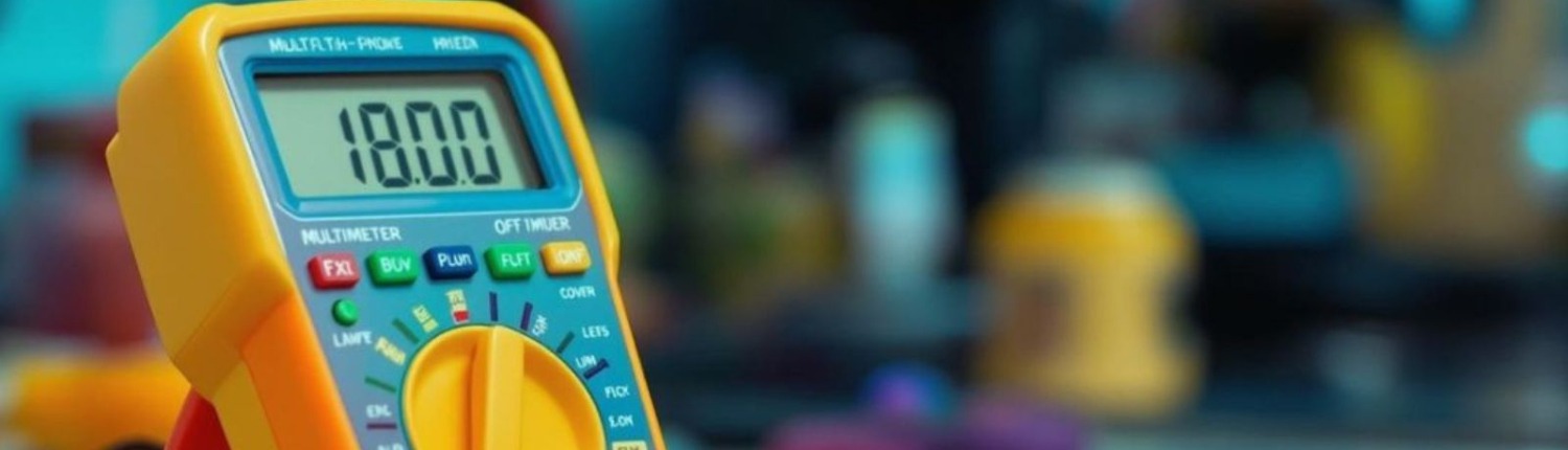

What’s on a multimeter display?
When you first look at a multimeter, you’ll see a display section that shows the measurements. If you’re using a digital multimeter, it’ll show numbers and units. If you have an analog multimeter, you’ll see a needle pointing to different values.
Here’s what you’ll see and what it means:
- Voltage, current & resistance: The numbers you see on the display will tell you the value of what you’re testing, and the units will show whether it’s volts (V), amperes (A), or ohms (Ω).
- Current symbols: The display may also include symbols like a straight line for DC (direct current) and a wavy line for AC (alternating current) so you know what type of signal you’re measuring
- Other readings: If you’re testing things such as a diode or continuity, then the display will show relevant information to confirm if the part is working or if there’s a problem.
