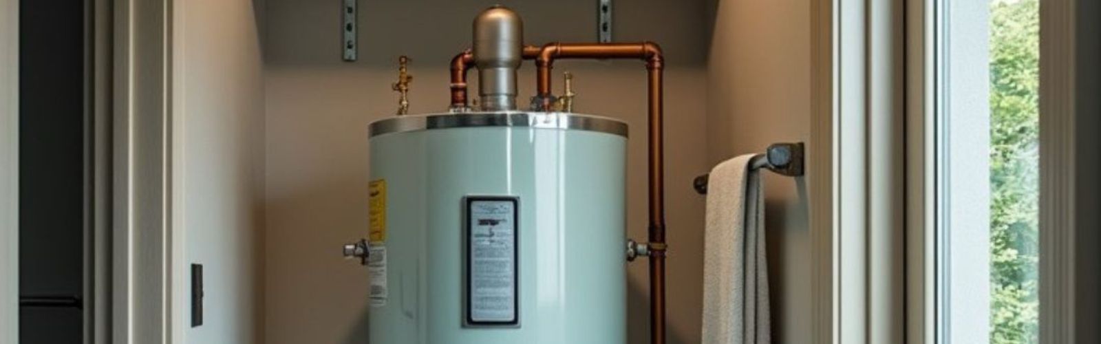

Is your water heater leaking, or is it struggling to drain? If so, the problem could be a faulty water heater drain valve. Let’s find out how you can replace it so you can get your unit back in action.
