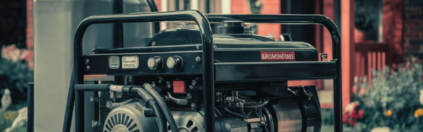

Let’s face it: when the power cuts out, your generator is your lifeline. To make sure it’s always ready to kick in when you need it most, a bit of routine maintenance goes a long way. So, let’s check out some easy at-home tips to give your generator the TLC it deserves.

First things first, give your generator a once-over. Keep an eye out for any obvious wear and tear.
- Loose bits and pieces: Make sure all the bolts, nuts, and screws are snug. Loose parts can mess things up.
- Frayed wires: Check the wiring for any frays or exposed spots. Wonky wires can be downright dangerous.
- Rust and corrosion: Spot any rust on the metal parts or gunk on battery terminals? These can throw a wrench in the works.
Watch out for leaks
Have a peek around and under your generator to see if anything’s dripping.
- Oil leaks: If you spot oil stains, it might mean a seal or gasket has gone bad.
- Fuel leaks: Smell gas or see any fuel? Could be a fuel line leak.
- Coolant leaks (if you’ve got ’em): For liquid-cooled generators, puddles of coolant can point to trouble with the cooling system.
