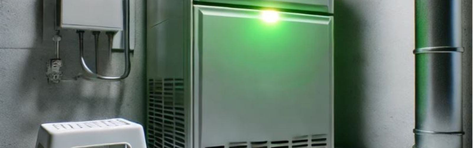

The green light on your furnace is a helpful indicator that tells you how things are running. If it starts flashing, it’s usually signaling a specific issue that needs attention. We’ll walk you through the most common causes and how to troubleshoot and fix them yourself. With a bit of patience and some basic tools, you can get your furnace back on track like a Pro.

1. Ignition problems
When your furnace’s green light starts flashing, one possible cause could be an ignition issue. This happens when the igniter, the part responsible for lighting the burner, isn’t working as it should. Without proper ignition, your furnace won’t produce heat. How to troubleshoot ignition problems:
