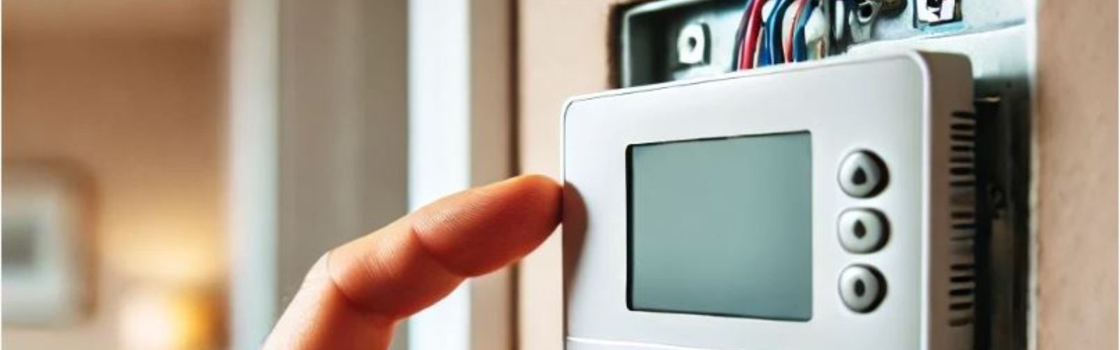

If your furnace isn’t working quite right, the thermostat could be the culprit. It’s the brain of the system, telling your furnace when to kick on and off based on the temperature in your home. If bad, it can lead to heating problems that are easy to overlook until they get worse. Luckily, many of these issues are DIY-friendly, and diagnosing a faulty thermostat early can save you a lot of hassle. We’ll look at five common signs your furnace thermostat might need replacing and walk you through how to fix the problem yourself.

Inconsistent temperature control
If your furnace isn’t holding a steady temperature, it’s a clear sign that something might be wrong with your thermostat. A bad thermostat could cause your furnace to run too hot or too cold, even if you adjust the settings. This could be due to a faulty thermostat sensor, a bad wiring connection, or a miscalibration that results in incorrect temperature readings. Here’s what to check:
- Make sure the thermostat is set properly. Adjust the temperature a few degrees up or down and see if the furnace responds accordingly.
- Use a separate room thermometer to check if the room temperature matches the thermostat reading. If there’s a big difference, the thermostat might be misreading the temperature.
- Check if there’s any dirt, dust, or debris on the thermostat, especially around the sensor. Cleaning it gently can sometimes fix minor inaccuracies.
If you’ve tried these steps and the problem persists, it’s likely that the thermostat is defective and needs to be replaced.
The thermostat is unresponsive or blank
A thermostat that doesn’t respond to changes or shows a blank screen can mean there’s an issue with its power supply or internal parts. This could happen due to dead batteries (if it’s a battery-powered thermostat), faulty wiring, or an internal failure. Here’s what to check:
- If your thermostat uses batteries, replace them with fresh ones to see if that fixes the issue.
- For wired thermostats, turn off the furnace and check the wires behind the thermostat. Look for any loose, disconnected, or corroded wires.
- If your thermostat is hardwired, check the circuit breaker to ensure it hasn’t tripped. If it has, reset it and see if the thermostat powers on.
If none of these steps work, the thermostat is likely broken and should be replaced.
The furnace constantly runs or won’t turn off
If your furnace seems to be running non-stop, or it doesn’t shut off even after reaching the set temperature, it’s a possible indicator that your thermostat might be the problem. This could be due to a thermostat stuck in the “on” position, a malfunctioning fan control setting, or a thermostat that’s misreading the temperature. Here’s what to check:
- Check the thermostat’s settings. Make sure it’s set to “Auto” rather than “On.” If it’s on “On,” the fan will run continuously, even when heating isn’t needed.
- Make sure the thermostat is reading the correct temperature. A bad thermostat may not properly sense when the room has reached the set temperature.
- Check if there are any drafts or heat sources near the thermostat, as these can cause false readings and keep the furnace running longer than necessary.
- If these steps don’t resolve the issue, the thermostat may need to be replaced.
Short cycling
If your furnace is constantly turning on and off in short cycles, the thermostat may not be accurately detecting the temperature, causing the furnace to overheat and shut off before it reaches the desired setting. Another possibility is that the thermostat is located in an area that’s too drafty or exposed to direct sunlight, leading it to shut off prematurely. Here’s what to check:
- Start by checking the thermostat’s location. If it’s near a drafty window, heat vent, or direct sunlight, try moving it to a more neutral location where it will get a more accurate reading.
- Clean the thermostat. Dust and dirt can interfere with its sensors, causing it to act erratically. Use a soft cloth or compressed air to clean the thermostat, especially around the sensor area.
- You can also check the wiring for any loose connections that might be causing short cycling.
- If the short cycling continues after these steps, replacing the thermostat is likely necessary to resolve the issue.
The thermostat is outdated
Sometimes, the problem isn’t a malfunction, it’s simply that your thermostat is old and no longer meets your needs. If your thermostat is basic or lacks modern features like programmability or Wi-Fi connectivity, it may be time for an upgrade. Technology has advanced, and newer thermostats can offer more precise control and convenience. Here’s how to decide:
- Take a look at the features of your current thermostat. Does it have a programmable schedule, Wi-Fi control, or other features that could make your life easier?
- Compare your current model with newer models available on the market. Many modern thermostats are designed to improve energy efficiency and come with easy-to-use interfaces.
- If you’re comfortable with basic electrical work, you can install a new thermostat yourself. Just make sure to follow the manufacturer’s instructions closely.
- Even if your thermostat seems to be working fine, upgrading to a new one could save you money on energy bills and give you better control over your home’s temperature.
