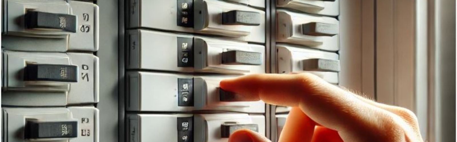

How to find the circuit breaker for your furnace
The circuit breaker that controls your furnace is usually located in your home’s main electrical panel. It’s typically a simple process to locate it, but it’s important to know exactly where it is so you can safely reset it. Here’s how to find the breaker for your furnace:
- The electrical panel is usually found in basements, garages, utility rooms, or hallways. It’s a metal box with rows of switches.
- The breaker dedicated to your furnace will often be labeled with “furnace,” “HVAC,” or “heater.” It might also be labeled with the amperage rating, such as “30A” or “40A.” If you’re unsure, refer to your home’s electrical diagram or the furnace’s manual for the exact breaker location.
- When a breaker trips, it may move to the “off” position or sometimes appear to be in between “on” and “off.” You’ll know it’s tripped if the switch is not fully aligned with the others.
Read more: Your guide to choosing a space heater
How to safely reset the circuit breaker
Resetting the circuit breaker is a simple process, but it’s important to do it safely. Here’s how to reset the breaker and get your furnace back in action:
- Before resetting the breaker, it’s a good idea to turn off your furnace completely. Set the thermostat to the “off” position and power down the furnace. This ensures no electrical components are running while you reset the breaker.
- If the breaker is already tripped, you may need to flip it to the “off” position first. This ensures that the circuit is completely disconnected from the power source.
- After turning the breaker “off,” flip the switch back to the “on” position. You should hear a click when it resets. Make sure the switch is securely in the “on” position, which will restore power to the furnace.
- Take a moment to ensure the breaker is fully in the “on” position. A breaker that’s not fully reset may not provide power to the furnace.
