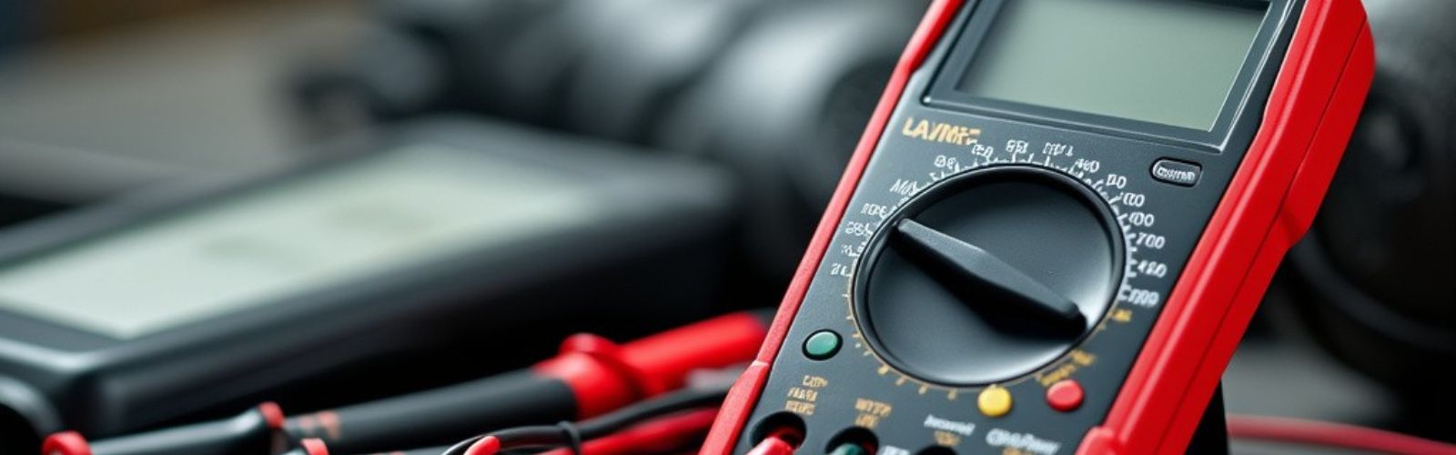

  • Multimeter – A digital multimeter with a diode test mode is the best option, but if yours doesn’t have this feature, you can still use the resistance (ohms) mode to check the diode.

Testing a diode is straightforward, but the method depends on your multimeter type. If your multimeter has a diode test mode, that’s the easiest and most accurate way to check a diode. If it doesn’t, you can use the resistance (ohms) mode instead.
If you’re testing a microwave diode, it’s also important to discharge the capacitor first since it can store dangerous amounts of electricity even after unplugging the appliance.
Method 1: Using the diode test mode (best method)
  1. Always disconnect power before working on any electrical components.
  2. Check your appliance’s manual or visit AppliancePartsPros.com for diagrams if needed. Diodes are usually small, cylindrical components with a stripe on one end (indicating polarity).
  3. Set the multimeter to diode mode. Look for a symbol that looks like a triangle with a line at the tip (this represents a diode).
  4. Place the multimeter probes on the diode terminals. Red lead to the anode (+) and black lead to the cathode (-) (the end with the stripe)
  5. A good diode should show a voltage drop of 0.5V to 0.8V in this direction.
  6. If you reverse the leads (black to anode, red to cathode), it should show “OL” (open line) or no reading, meaning the diode is blocking current in that direction.
  7. If the diode conducts in both directions (shows a number both ways), it’s shorted and needs to be replaced.
  8. If the diode blocks current in both directions (no reading both ways), it’s open and also needs to be replaced.
