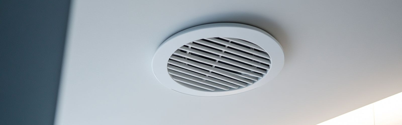

Ever flip on your bathroom fan, only to be greeted by that low buzz and no airflow? That humming sound often means the fan’s motor is getting power but can’t spin the blades. Don’t worry, you can tackle this on your own. Below, you’ll find common causes and straightforward fixes to help silence that annoying hum and keep steam from fogging up your mirror.
