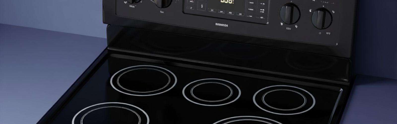

Is your Samsung range causing culinary chaos with unexpected malfunctions? If the control board—the heart of your range’s electronic operations—is on the fritz, it might be time for a checkup. Our step-by-step guide, complete with a detailed how-to video below, will empower you to troubleshoot and restore your appliance’s functionality, ensuring your kitchen remains the hub of delicious creations.

When your Samsung range starts acting up, the culprit could be a faulty main control board. The control board is the brain of your range, responsible for managing all the electronic functions. Properly testing the control board can help you determine if it needs to be repaired or replaced. Let’s dive in and get your Samsung range working like new.
