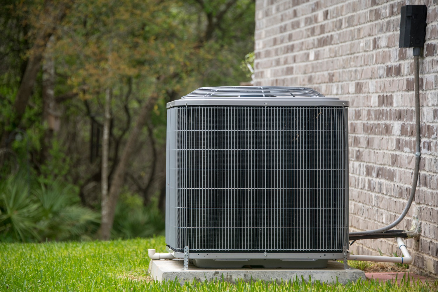

Does it seem like your air conditioner unit isn’t working as well as it did last year? Maybe you’re stunned by a big jump in the cost of your electric bill? Don’t spend your summer suffering in front of the oscillating fan – you may be able to fix your AC unit’s efficiency issues with a bit of maintenance, and AppliancePartsPros.com is here to show you how!
In this guide, we’re walking you through the how and why of cleaning your AC unit’s air filter. Whether you’ve got central cooling or a window unit, we’ll show you how it’s done. Keep reading!
