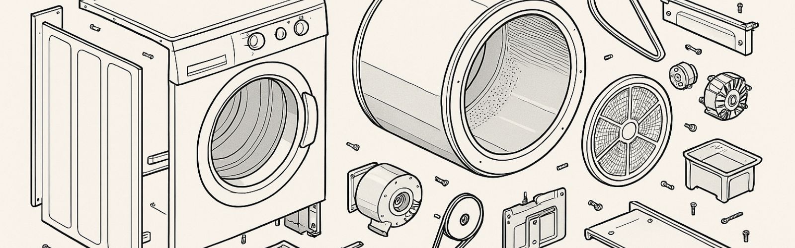

Let’s break down all the major parts of a clothes dryer, what they do, why they matter, and how they keep your laundry routine running smoothly.
1. Drum
The drum is the big round chamber where you toss your clothes. It rotates during the cycle, tumbling clothes around so hot air can circulate evenly and dry everything efficiently.
- Why it matters: Without tumbling, your clothes would just sit in a damp heap and take forever to dry.
Most drums are made of stainless steel or coated metal to withstand heat, moisture, and repeated wear and tear from zippers, buttons, and random pocket change.
2. Heat Source (Gas Burner or Electric Element)
Here’s where dryers split into two types: gas and electric.
- Electric dryers use a heating element (kind of like the coil on a toaster) to generate hot air.
- Gas dryers use a burner system that ignites natural gas or propane to produce heat.
Either way, the goal is the same: warm up the air that flows through the drum and dries your clothes.
- Why it matters: No heat = no drying. If your clothes are still damp after a full cycle, this might be the part to blame.
3. Blower Fan
The blower fan is basically the lungs of your dryer. It draws in air, pushes it past the heat source to warm it up, and then forces that hot air into the drum.
Once the air picks up moisture from your clothes, the blower fan sends it out through the exhaust vent.
- Why it matters: No airflow means your dryer is just spinning clothes around in warm, stale air, not very effective.
4. Exhaust Vent
After hot air flows through the drum and picks up moisture, it has to go somewhere. That’s where the exhaust vent comes in.
It carries the now-wet air out of the dryer and sends it through the vent hose and out of your house.
- Why it matters: A clogged or kinked vent can make your dryer work harder, take longer to dry clothes, or even become a fire hazard.
5. Lint Filter
The lint filter traps all the fluffy bits that come off your clothes during drying. If it didn’t exist, lint would build up inside the dryer and vent system, bad news for both performance and safety.
- Why it matters: A clean lint trap helps your dryer run efficiently and reduces the risk of fires.
Pro tip: Clean it after every load. Seriously. Just do it.
6. Control Panel / Timer
This is the part you interact with, whether it’s a set of dials, buttons, or a fancy touchscreen. The control panel tells the dryer what cycle to run, how hot to get, and how long to run.
- Manual timer dryers just count down the time.
- Electronic models have sensors and programs for auto-dry settings.
- Why it matters: If your control board is glitching, your dryer might not start, heat, or stop properly.
7. Drive Motor
The drive motor is what makes the drum spin. It’s also responsible for powering the blower fan in most models.
- Why it matters: If your drum isn’t turning but the dryer is on, the motor might be worn out or jammed.
Sometimes motors have a built-in switch to shut them down if they overheat, kind of like a reset when they’re overworked.
8. Belt
The drive belt loops around the drum and the motor. When the motor turns, the belt spins the drum. Simple but essential.
- Why it matters: A broken or loose belt means your clothes won’t tumble, and drying will be uneven or just not happen.
If your dryer is running but the drum isn’t spinning, it’s probably a belt issue.
9. Door Switch
This little switch is triggered when the dryer door closes. If the door isn’t shut properly, the dryer won’t start, period.
- Why it matters: It’s a safety feature to keep your dryer from running with the door open.
If your dryer won’t start at all, check that the door switch is clicking and working.
10. Moisture Sensor
Newer dryers have moisture sensors inside the drum to detect how wet the clothes are. When the clothes are dry enough, the dryer shuts off, saving time and energy.
- Why it matters: It prevents over-drying, saves money on your electric or gas bill, and helps your clothes last longer.
If your dryer is turning off too early (with damp clothes), your sensor might need cleaning or replacing.
11. Start Switch / Push Button
This is exactly what it sounds like. You push the button or turn the dial, and it sends a signal to the control board or motor to start the cycle.
- Why it matters: No start = no dry. If nothing happens when you press the button, it could be the start switch or a problem with the door switch or timer.
12. Thermostats & Thermal Fuses
Dryers get hot, but not too hot, and that’s thanks to thermostats and thermal fuses.
- Thermostats help maintain the correct temperature by switching the heat source on and off.
- Thermal fuses are safety devices that cut power to the heating element if the dryer gets dangerously hot.
- Why it matters: A blown fuse or bad thermostat can stop your dryer from heating.
If your dryer runs but doesn’t heat up at all, these are often the first parts to check.
13. Burner Assembly / Igniter (Gas Dryers Only)
In a gas dryer, the burner assembly is where the real firepower happens.
- The igniter heats up and lights the gas.
- The gas valve opens and lets fuel flow.
- A flame sensor keeps everything safe by shutting it down if something’s off.
- Why it matters: If your gas dryer isn’t heating, the igniter or flame sensor could be the issue.
14. Cool Down and Wrinkle Guard Features
Some dryers have a cool-down cycle at the end to prevent overheating and reduce wrinkles. Others have a wrinkle guard, which tumbles clothes every few minutes after drying is done (in case you forget them in the drum, no judgment).
- Why it matters: Saves your clothes from heat damage and saves you from ironing.
15. End-of-Cycle Signal
Love it or hate it, the end-of-cycle buzzer lets you know your laundry is done. In newer models, you might hear a cheerful chime instead of a jarring buzz.
- Why it matters: It’s optional, but a handy reminder to grab your clothes before they wrinkle.
