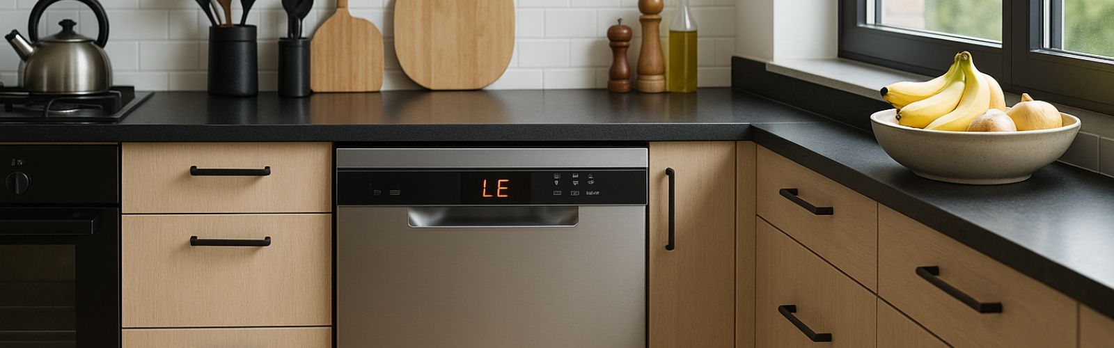

Is your LG dishwasher displaying error code LE? Don’t worry, this is a problem that you can fix yourself without the need for a costly service call and we’re here to help you do it!

What the error code means
The error code “LE” on an LG dishwasher means that the main control board is unable to sense the rotation of the washing motor. This suggests an issue with the washing motor or wiring connection.
