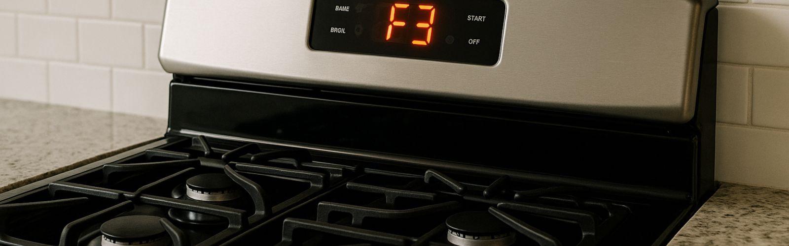

Is your GE gas range displaying the error code F3? Don’t worry, we’ve got you covered. This is a troubleshooting problem that you can fix yourself without the need for a costly service call, and we’re here to help!
If you find out that you need any replacement parts for your appliance while you’re troubleshooting, you can enter your model number at AppliancePartsPros.com to order them. Most orders arrive in just two business days, and we have thousands of free guides to show you how to install your new parts.
The information in this article may not apply to your specific appliance model. We recommend consulting your manufacturer’s documentation or contact us with any questions.
What does the error code mean?
Pro tip- Stored error codes can be recalled by pressing “KITCHEN TIMER ON/OFF”, “CLOCK”, and “9” simultaneously. While the error code is displayed, pressing 8 and 6 together will clear it.
F3 open sensor code
- Indicates the electrical resistance through the oven sensor circuit is too high.
- Typically appears when the wiring to the oven sensor is damaged, or disconnected, or the sensor itself has failed to open internally.
- Results in the electronic range control (ERC) received no usable temperature measurement data from the sensor.
Essentially, the control board (ERC) is not getting accurate temperature readings from the sensor and displays an error code to alert you to the problem.
