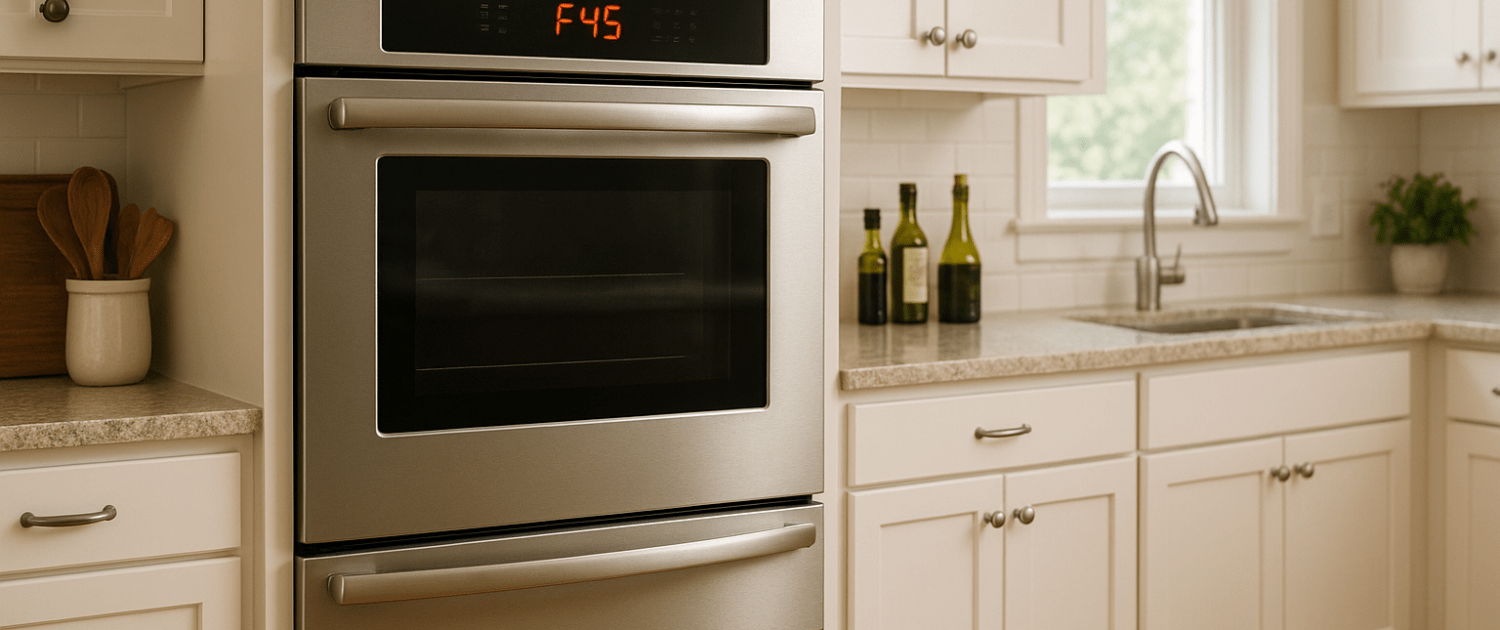

What is the F45 error code?
The F45 error code indicates a problem with the upper oven door latch in Bosch double wall ovens.
Specifically, it means the electronic control board is receiving conflicting signals that the door is both locked and unlocked at the same time. This understandably confuses the control board.
Inside your double oven, the upper and lower ovens each have their independent latch mechanisms. The latch uses a motor and switch assembly to lock the door during self-cleaning cycles and unlock when cooling completes.
Two switches provide door position status back to the control board. When the F45 code is thrown, the control sees both switches active simultaneously, meaning the door is reporting that it’s somehow both locked and unlocked at once.
