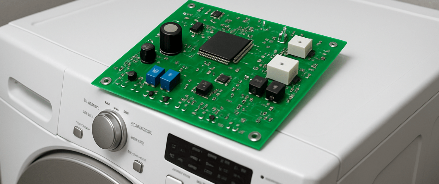

Washer acting up with random stops, error codes, or refusing to start? If you own a Whirlpool or Maytag model, the main control might be to blame. This component is the brain of your machine, and when it malfunctions, so does everything else. Before you call in the pros, let’s break down the signs that scream it’s time for a replacement.
