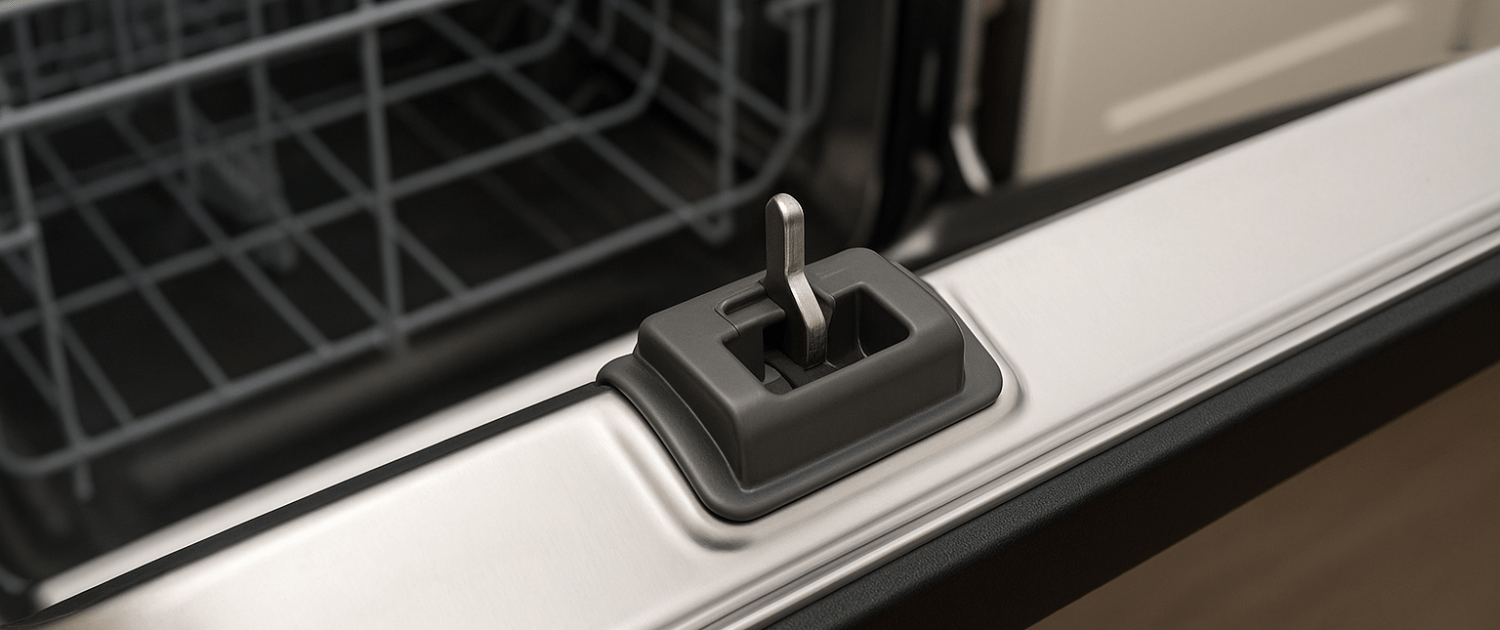

If your Whirlpool dishwasher won’t start or keeps stopping mid-cycle, the door might not be latching properly. The door latch, part number 8193830, is what keeps the door securely closed during a wash. When it’s worn out or broken, your dishwasher might think the door is open even when it’s shut. Thankfully, replacing the latch is a straightforward DIY job that can solve the problem quickly. In this guide, we’ll walk you through how to remove the old latch and install a new one to get your dishwasher running smoothly again. Let’s get started.

Step 3- Remove the faulty door latch
- Use the 3/16-inch nut driver to remove the screw holding the switch in place.
- Lift the switch up and off the alignment pin, taking care to thread the attached wires through the plastic holdings so they don’t get damaged.
- Using a flathead screwdriver, gently pry up on the plastic locking tabs on either side of the door latch housing to release the assembly.
- With the tabs loosened, pull firmly to slide the entire door latch mechanism forward and detach it from the dishwasher frame.
