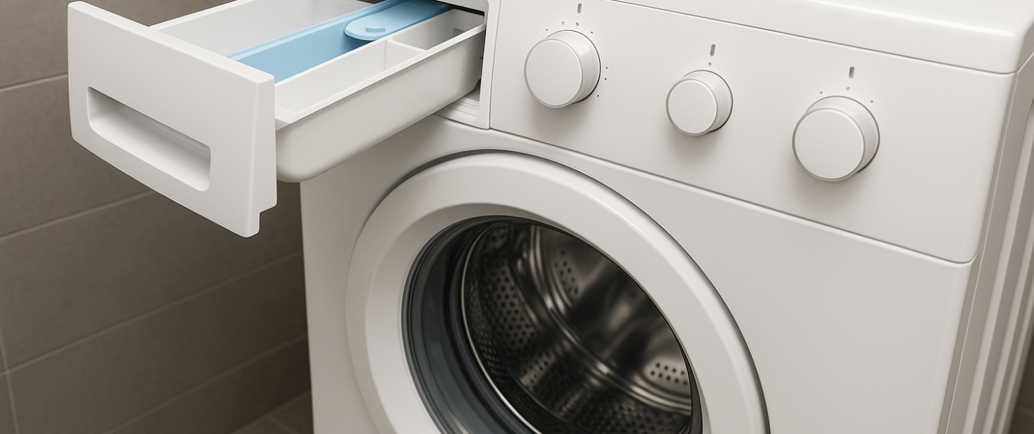

Step 1. Prepare the dispenser assembly
- Pull the dispenser out.
- Push down the tab.
- Slide the dispenser assembly completely out.
Step 2. Test the dispenser assembly
- Remove all inserts from the dispenser.
- Examine the dispenser for mold growth and soap buildup.
- Check if any mold or soap buildup is blocking the holes and causing overflow.
Step 3. Clean the dispenser assembly
- Soak the dispenser in white vinegar.
- Use a sponge to clean it in hot water.
- Remove all residue before reinserting.
Step 4. Replace the dispenser assembly
- Place the inserts back inside the dispenser.
- Slide the dispenser back into the washer.
