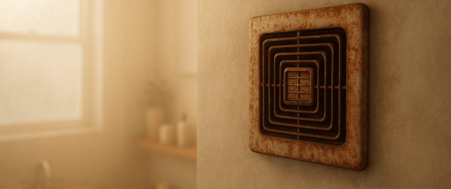

Your bathroom fan might not be the flashiest fixture in your home, but it plays a crucial role. It pulls out excess humidity, clears out odors, and helps prevent mold and mildew. But with all that steamy air rushing through, it’s no surprise that corrosion can become a problem over time.
If your fan is making strange noises, smelling metallic, or looks a bit worse for wear, there’s a good chance corrosion is creeping in. The good news? You don’t have to rush out and buy a brand-new fan. In many cases, you can spot, clean, and fix corrosion yourself with just a few basic tools and a little elbow grease.
Let’s break down exactly how to find corrosion in your bathroom fan and how to clean it up like a DIY pro.

Once the cover is off, give it a good look. If you see brownish-red spots, flaking metal, or a powdery white buildup (on aluminum), you’re dealing with corrosion.
Set the cover aside. If it’s metal and corroded, you’ll clean it later. If it’s plastic, inspect for damage or brittleness caused by moisture.
