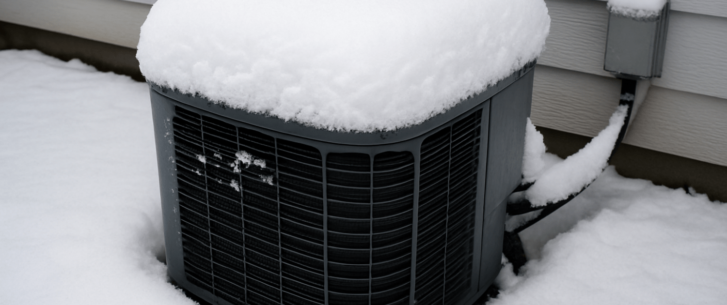

Cover and Protect the Condenser Unit
Covering your AC’s outdoor unit helps protect it from snow, ice, falling debris, and nesting animals. That said, it’s important not to seal the unit completely, as that can trap moisture and promote rust.
Tips for covering your AC:
- Use a breathable cover designed for AC units (not a plastic tarp).
- If using a tarp, leave some space at the bottom to allow airflow.
- Secure the cover with bungee cords or zip ties so it doesn’t blow away.
- Place a piece of plywood and a brick on top if you’re worried about icicles or heavy snow falling from above.
Some homeowners skip the cover altogether in mild climates, but it’s a smart idea if your winters are cold, snowy, or windy.
