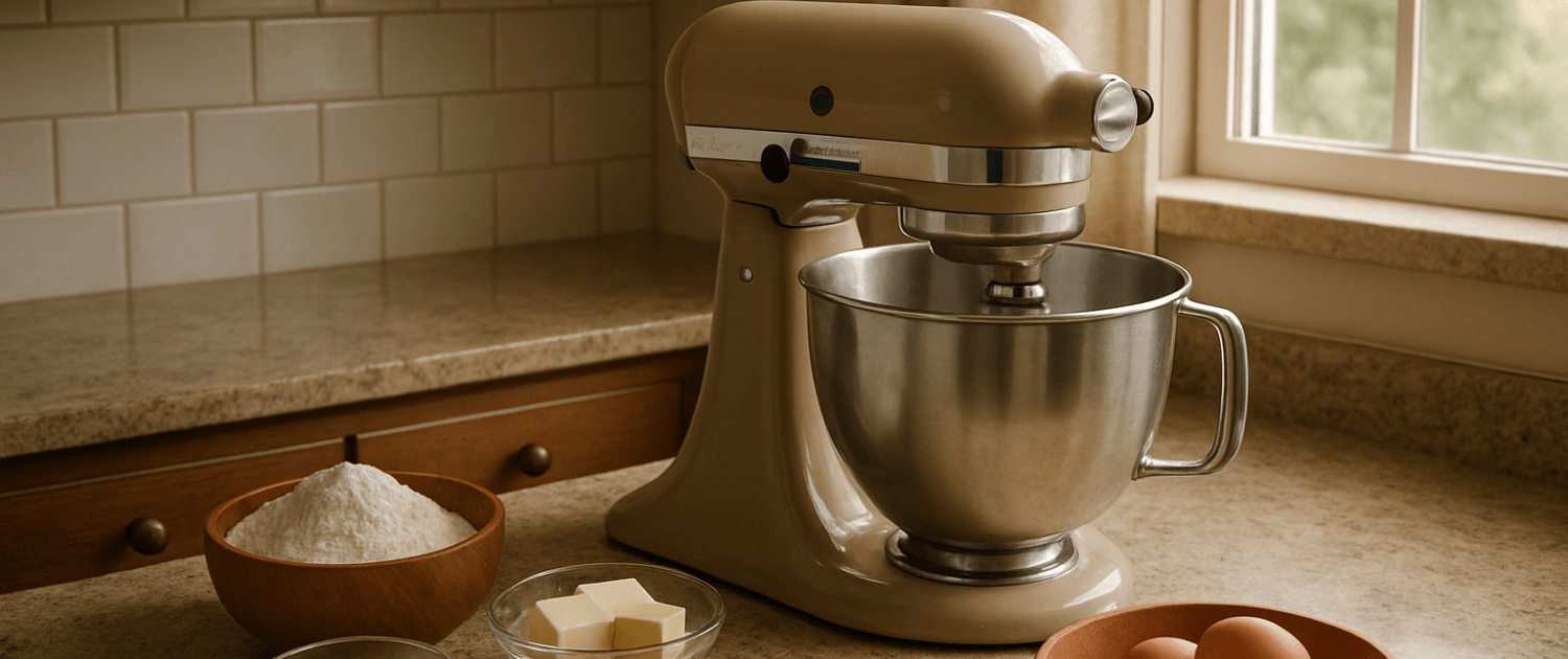

So you’ve got a KitchenAid stand mixer that whips cream like a dream and kneads dough without complaint, and you’re wondering if it can pull double duty at your café, bakery pop-up, catering gig, or food truck. Short answer: It can, if you understand its limits, set up the workflow right, and plan for maintenance. Think of it like bringing a reliable compact car into rideshare duty: totally doable for everyday routes, not the best choice for hauling bricks all day.
This guide walks you through the real-world considerations: capacity, duty cycle, sanitation, safety, workflow, power, maintenance, and when it’s time to step up to a true commercial mixer. Grab a coffee and let’s make a plan.
