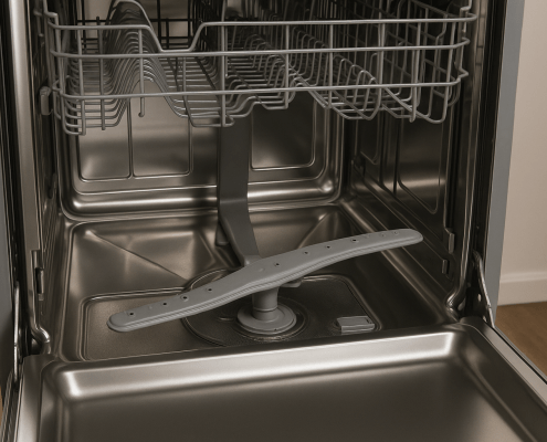

Clean the interior
A clean interior will help all those dishes shine after washing and prevent foul odors. Plan to deep clean your dishwasher 1-2 weeks before Thanksgiving so you have a fresh machine to work with. Here’s how to target hidden gunk and food debris:
- Check under the rubber door gasket flap for debris buildup and wipe it off.
- Open the door and check the filter at the bottom. Remove any debris caught in the filter and soak and scrub it if it’s very dirty.
- Check the spray arm holes for any obstructions. Use a toothpick to clear them.
- Wipe debris from the detergent dispenser housing.
- Remove built-up gunk around the dish rack rollers and mounting hardware.
- Wash the interior with dish soap, warm water and a soft brush. Pay special attention to small, hidden crevices.
- Put vinegar in the dispenser and run a rinse cycle to sanitize the machine.
- Sprinkle baking soda in the dishwasher afterwards to freshen.

Check the rotation of the spray arms
Spray arms help water cover all the dishes during the washing and rinsing processes. The spray arms need to be able to rotate freely and remain clear of any debris.
- Remove the spray arms and examine each one for any cracks and obstructions. Remove blockages and other debris with a toothpick.
- Confirm the arms rotate smoothly when turned by hand. Listen for grinding sounds, which indicate something is worn out and needs to be replaced.
- Replace defective spray arm components like bearings or seals if needed.
- Adjust your dishes and racks to prevent contact with the spray arms during a cycle.

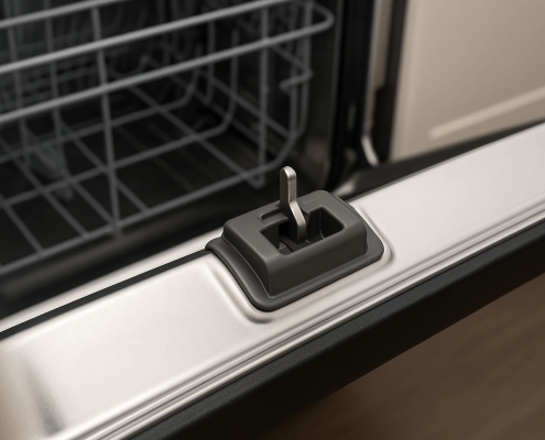

Inspect the door seal
The door gasket (also known as a door seal) keeps the water and moisture in the machine to prevent leaks. If you notice any of the following issues, you’ll need to clean or replace your dishwasher’s gasket:
- Brittle or cracked regions that allow water to escape.
- Mineral deposits or soap scum buildup that’s interfering with a tight seal.
- Mold or mildew, which indicates a persistently wet gasket that needs cleaning.
- Gaps between the gasket and tub that allows for water seepage.

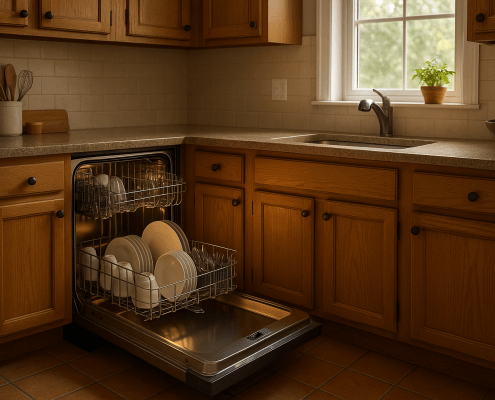

Adjust the dishwasher’s legs if needed
A rocking, unstable dishwasher can be noisy and unable to clean as well. Taking the time to level your dishwasher helps it operate at its best. Here’s how to do it:
- Make sure all four dishwasher legs touch the floor.
- Use a bubble leveler to make sure the dishwasher is evenly balanced side-to-side and front-to-back.
- Twist any adjustable feet under the front to raise or lower that side if needed.
