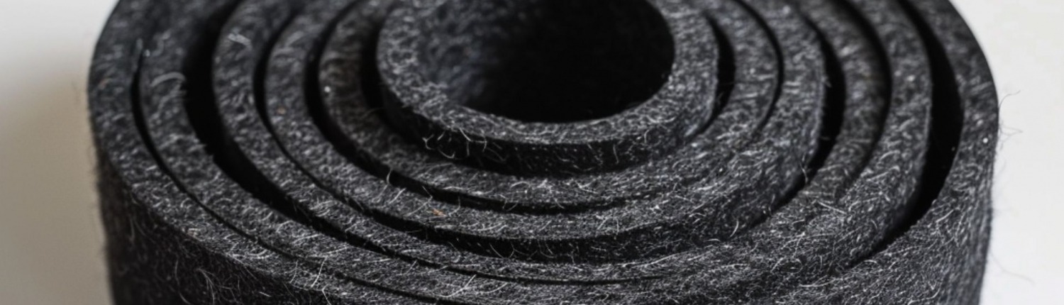

Is your laundry getting caught on the inside of your dryer? This can be an annoying issue that can cause damage to your laundry over time. If the material keeps getting caught on the bottom edge of the drum, then the lower drum felt seal likely needs to be replaced.
Let’s unpack the process so you can swap out the worn seal for a new one.
