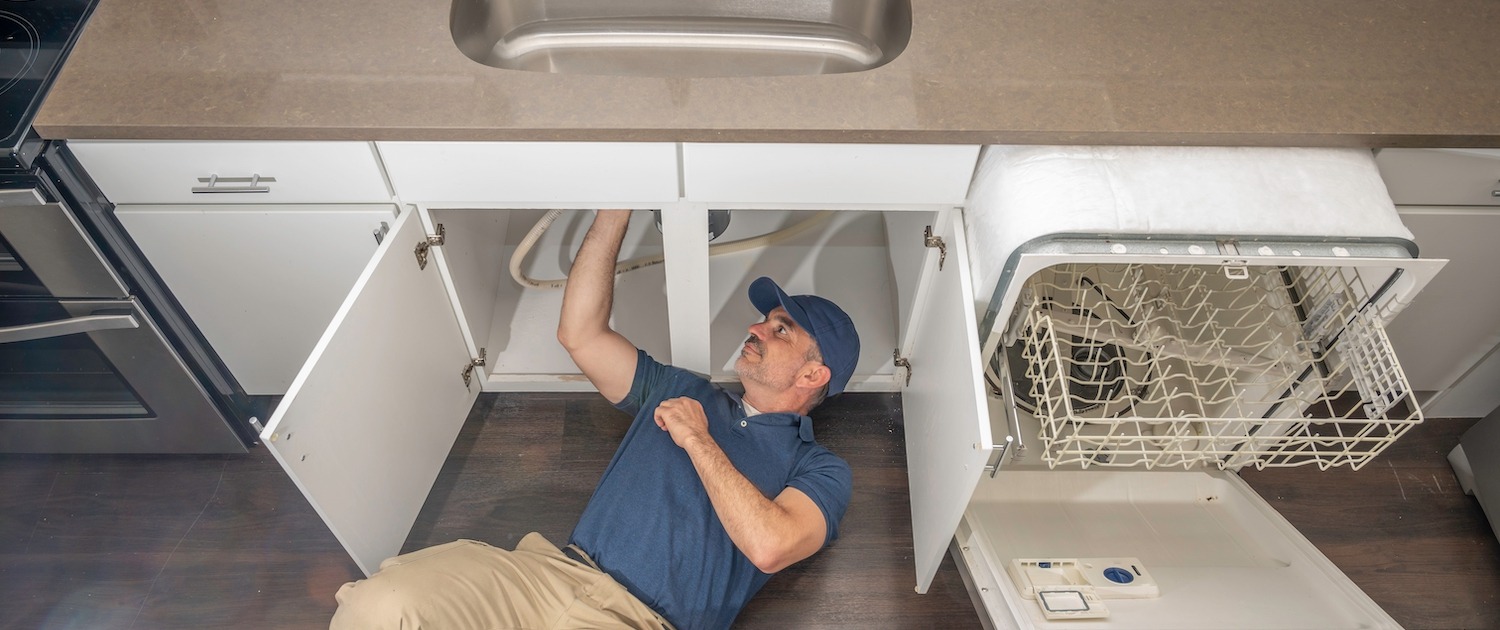

- Move the dishwasher closer to the counter and feed the water, drain and power lines through the holes in the cabinet.
- Push the dishwasher into the cabinet space about halfway, making sure that the insulation isn’t bunching up.
- Reach under the sink. You should see the dishwasher lines. Pull on all of those to better thread them through and make sure they aren’t bent, kinked, or caught on anything.
- Install the mounting brackets onto the dishwasher. These will go across the top of the dishwasher, hooking into the frame. They should have a tab that can be bent over to secure the bracket. Once in place, use pliers to break off excess metal to make sure the brackets don’t stick out over the countertop.
- Push the dishwasher in all the way, being mindful that you don’t damage your floor.
- Connect the water, drain, and power lines beneath the sink.
- The drain hose should come with a universal fitting meant to fit two sizes. If the larger size is too big, trim it off and use the smaller opening to secure it to the air gap with a clamp.
- The water line can be secured to the hot water valve beneath the sink.
