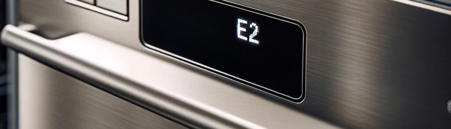

If your Bosch dishwasher is displaying an E2 error code, it usually indicates a problem with the NTC (temperature) sensor. You’ll most likely need to fix the faulty NTC sensor or related wiring.
If you find out that you need any replacement parts for your Bosch dishwasher while you’re troubleshooting, you can enter your model number at AppliancePartsPros.com to order them. Most orders arrive in just two business days, and we have thousands of free guides to show you how to install your new parts.
Disclaimer: The error code information in this article is based on general service manuals and may not apply to your specific appliance model. While we strive to offer helpful advice for DIY appliance repairs, variations in models and configurations can lead to differences in troubleshooting steps, error codes and part replacements. For the most accurate guidance, we strongly recommend consulting the technical sheet for your specific appliance model.
What does the E2 error code mean?
The E2 code specifically indicates that the control module has detected an issue with the NTC (“negative temperature coefficient”) sensor’s output. The NTC sensor monitors the temperature of the water during the dishwasher’s wash and rinse cycles. Depending on the model, it’s on or near the heating element and detects resistance changes as the water heats up. The resistance decreases as the temperature rises.
If the control module isn’t receiving the expected resistance values from the sensor, it will trigger the E2 error. This could mean:
- The NTC sensor has failed
- There’s a wiring problem between the NTC and the control module
- The control module’s input circuitry has malfunctioned
