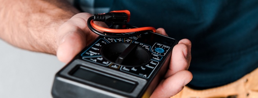

Take the part out and visually inspect it before you test it. If the start capacitor appears as if it has been leaking or is bulging, it will need replacement. If everything looks fine, use a multimeter to test the ohms of the component. Some multimeters will automatically detect the level of ohms, while you may need to do this manually in other cases.
Before doing testing, discharge the capacitor by removing the wires and placed an insulated screwdriver on the top. Be sure not to touch the metal of the screwdriver during this process. Next, place the probes on each terminal and see if the ohms reading rises and then goes back down. Switch the probes to the other terminals and the same thing should occur. If not, the part will need to be replaced.

If this test does nothing, there is another option. Double check the refrigerator is unplugged and then use a multimeter to see if the cold control carries an electrical current. The meter should be set to continuity and the probes pressed together to ensure the meter is working the way it should be.
To test the cold control, the control area needs to be opened and the wires should be removed. Turn the cold control to the “off” position and then press one probe to each terminal. At this point, the multimeter should show no continuity. Next, turn back on the cold control and repeat the process. There should be continuity when running the second test. If this isn’t the case, the cold control will need to be replaced.
