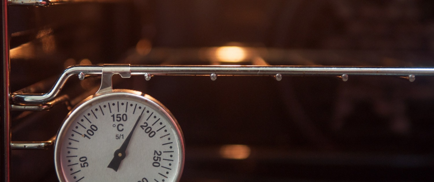

No need to get pricey with your tools here. All you need to complete this test is a large loaf of cheap white bread. If you have a big oven, grab two loaves. Optionally, a cheap oven thermometer can also help to make things more precise. Just follow these steps:
- Starting with a cool oven, slide your oven racks into place if they aren’t there already. If you have a baking stone or aluminum foil in there, remove it now.
- If you have an oven thermometer, set it up in the center of the middle rack now.
- Preheat your oven to 350° F (176.6° C). Depending on your oven, this should take around 30 minutes to reach. You can use an oven thermometer to verify that the internal temperature is correct.

- Optionally, an oven thermometer
Once you’ve got what you need, here’s what to do:
- Move one oven rack to the middle of your oven, and, if you have one, set up your oven thermometer on the rack now.
- Preheat your oven to 400° F (204.4° C). Depending on your oven, this should take at least thirty minutes, possibly upwards of forty. You can verify the temperature with that oven thermometer once the range says it’s preheated.
